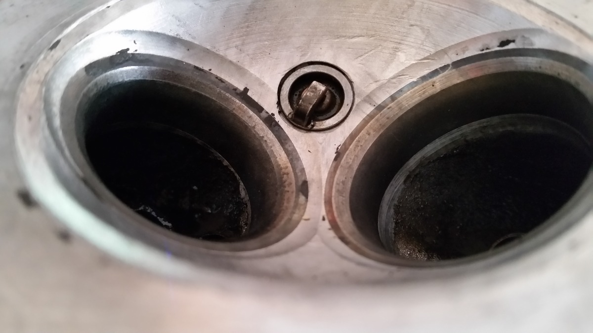

I started cleaning the combustion chambers on the head. The only thing that appears to work to remove the buildup is a brass wire wheel on my rotozip.
Here's an image of the first chamber I've cleaned.
I'm burning through brushes this way. Has anyone got a better method? I don't mind losing the brushes but I'm concerned about all the little wires and getting all of them out of the head.
So far I've not seen any cracks by the spark plug hole. I'll keep a look out though.

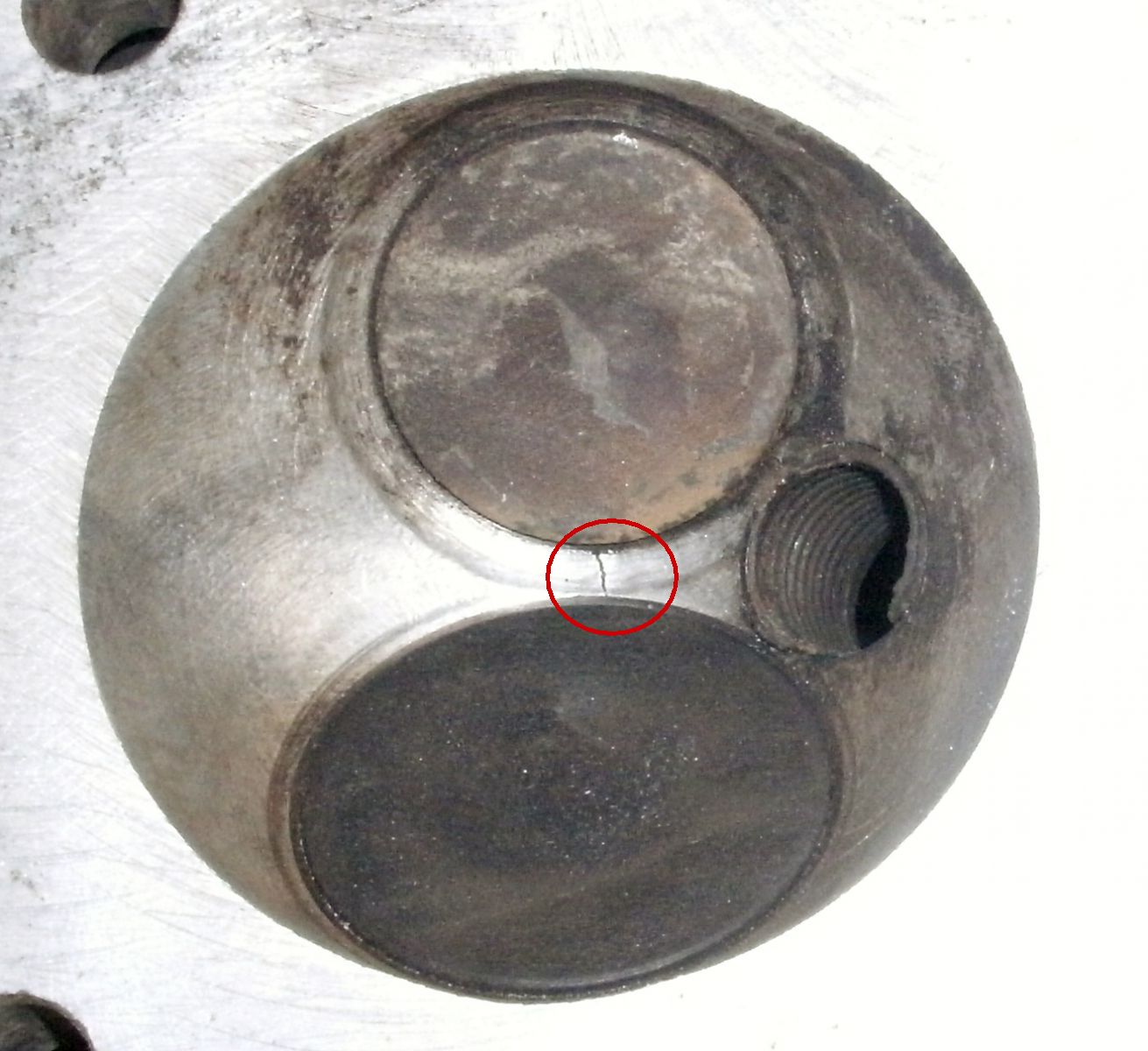

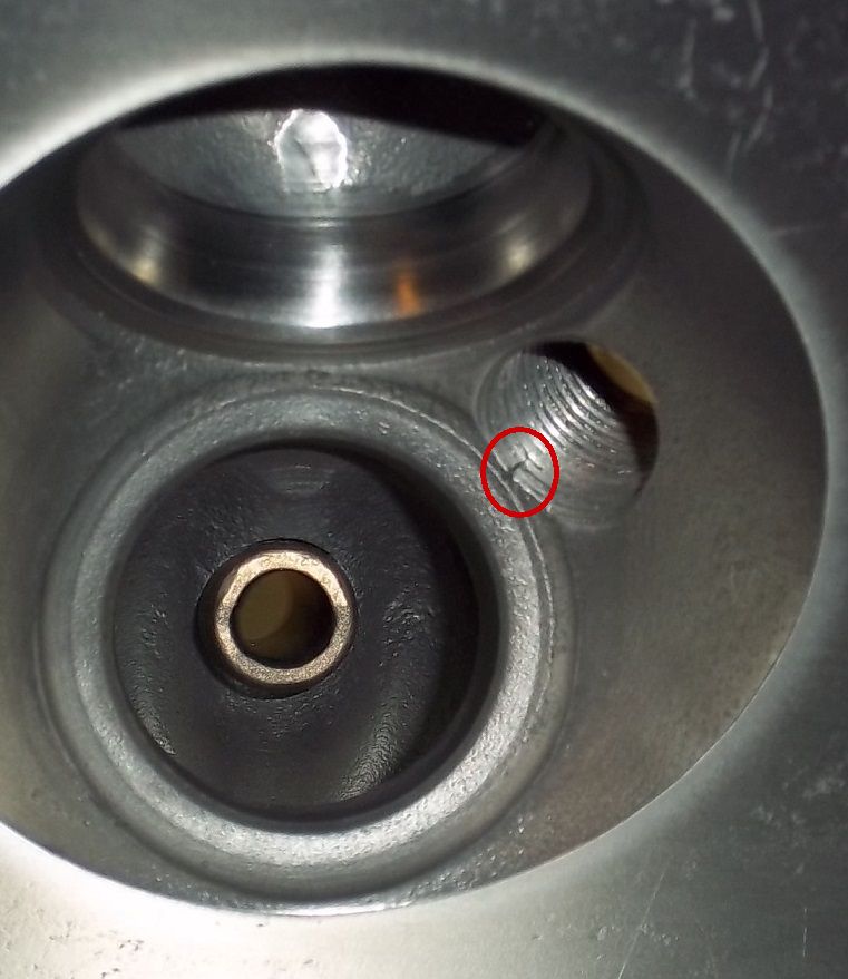

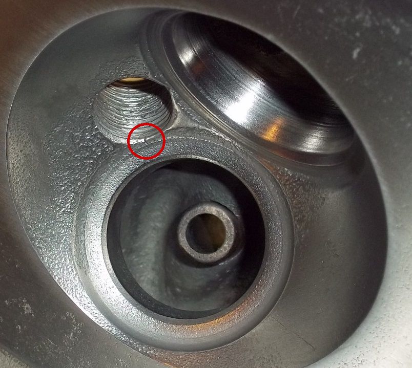

Cracks in the spark plug hole and between the valve seats looks like this
www.kzrider.com/forum/2-engine/559927-in...hroat-and-valve-size
kzrider.com/forum/2-engine/596971-the-co...ead-by-ex-valve-seat
