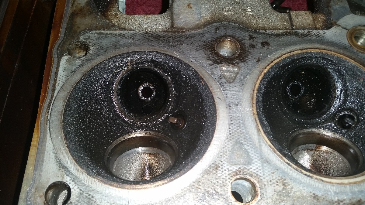

After getting the parts back to the house I set about disassembling the engine. After pulling and disassembling the head I noticed what appears to be burnt oil in the combustion chamber and exhaust port.

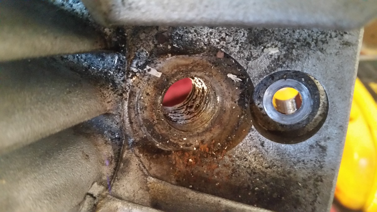

One of the spark plug holes also appears to be destroyed. I think this can be fixed with a time sert.
The rest of the head looks okay but the oil in the combustion chambers is disconcerting. Should I keep this thing? Or is it going to be too much trouble? I can provide more photos if necessary.

You gotta clean everything and then measure: valve guide to valve stem clearance, seat contact pattern, etc. When you have all the measurements then judge. Oh, and the head is line bored with the caps installed. That said, many guys that have lost caps have gotten away with replacing them with cap(s) from a different engine. I'm not sure about a full set of caps though.

Looks like bad valve guide seals by the intakes. What are your plans?

I'm going to start with cleaning everything like Nessism suggested. Then check the head against the requirements in my service manual.
I suspected the valve seals were not great. When I pulled the head there were pools of oil on top of the 2&3 pistons. So either the seals were letting in oil from the top or it was getting past the rings from the bottom and the rings didn't look that bad after a first glance.

When you get the combustion chambers clean check carefully for cracks between the plug hole and valve seats.
