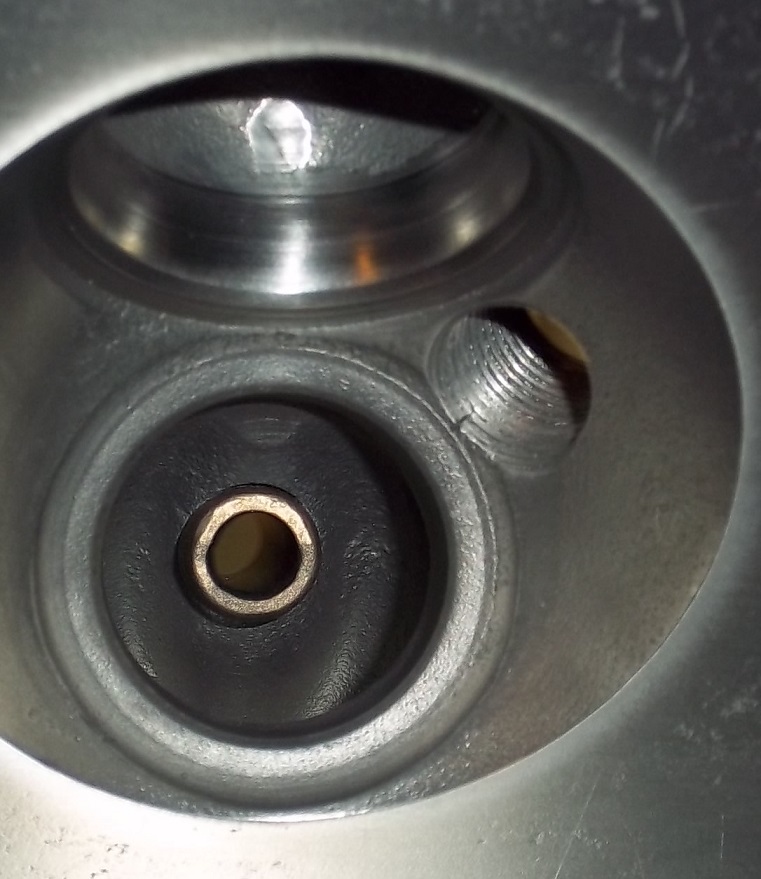

Hello Guys. Thanks for the replies. I do have this head. I will get some pictures up later today, Thurs.
If I can get a smaller, detailed picture to show them. And some other issues. 2 exhaust studs boss' were heli arc welded a small amount and I put some heli coils in.
Yes, I myself would use this head, but it needs new valve guides and a valve grinding of course.
It would be a nice early head for restoration.

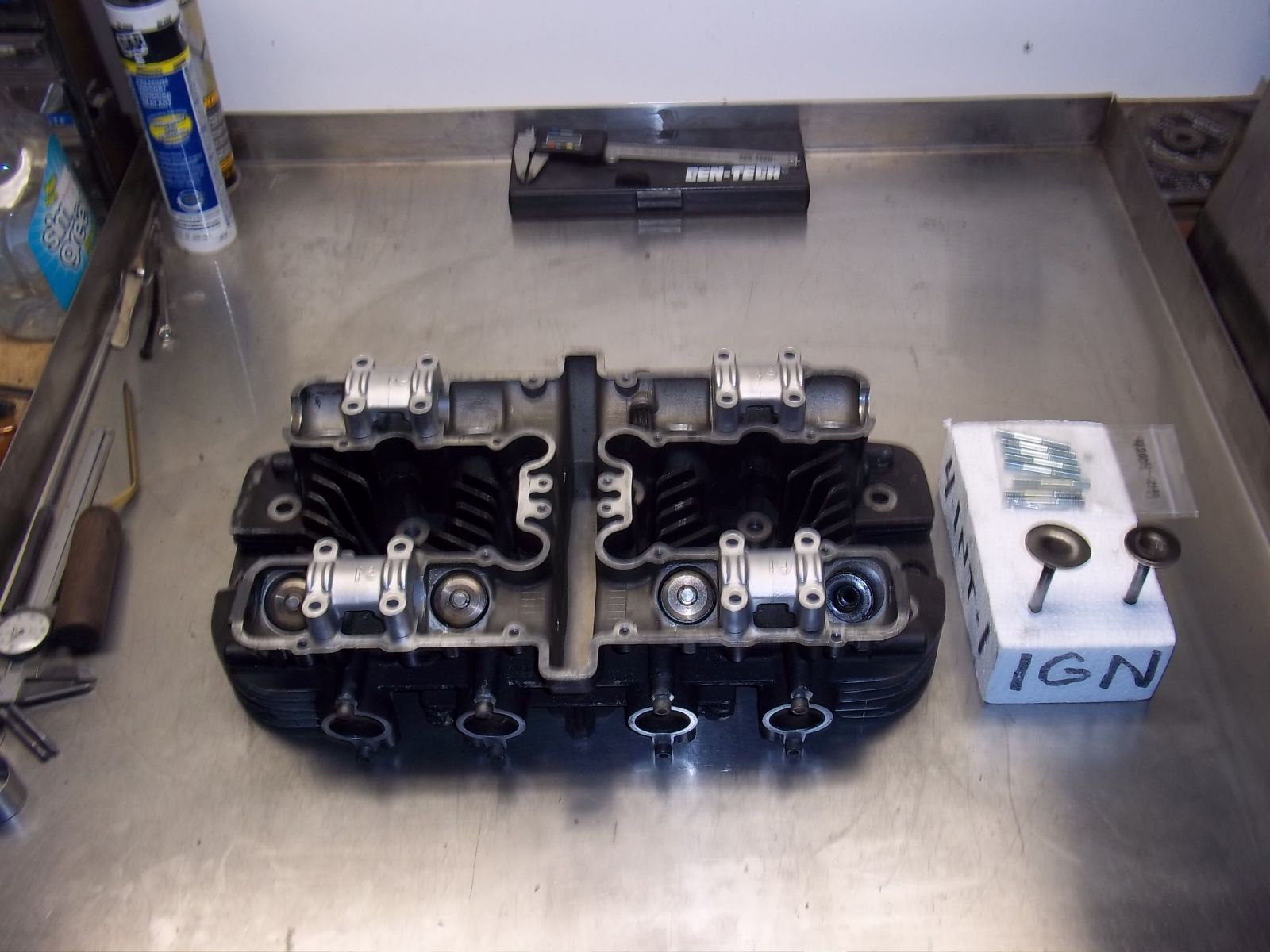

Started to take some pictures. This was a later style fin, 1973 black factory head. It has the castings for the early style vacuum nipples, but not used. This head has been sitting since the early 1990's?? When I used to drag race. I got all kinds of parts and engines, traded, given to, etc.
I fixed a couple exhaust studs way back then. Put some heli-coils in for exhaust studs.
All the fins are perfect. Nice restoration core. In my opinion.
Has the matching caps. first time taken apart. Needs exhaust guides they are too loose.
lot of meat on the valves and seats for grinding.
I am stopping here. Not going to invest that work. Won't get it out of an ebay deal.
I figure I will offer it up to the World. Early heads are getting scarse. OinkJohnson sells the hell out of them always.
But here are some detailed pictures.

22 Jan 2015 10:42 - 22 Jan 2015 10:45Those surface nicks hardly qualify as cracks.
They are barely scratches and nothing to worry about.
