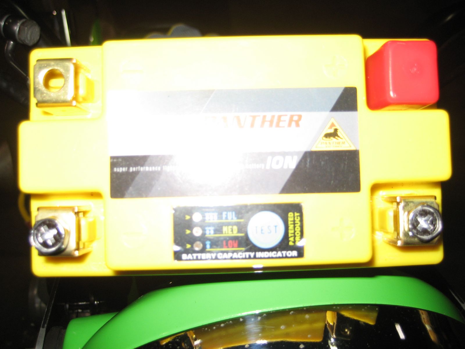

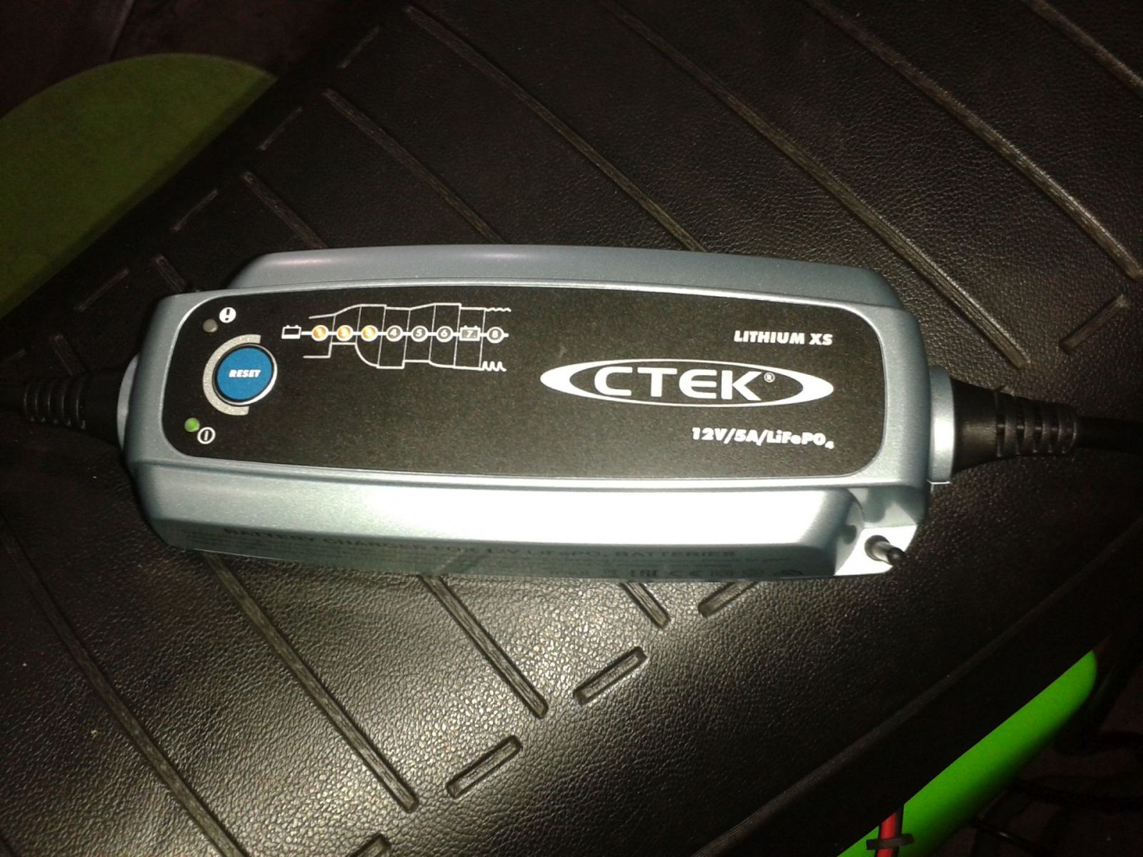

This is one of the reason i use a LiFe-ion battery on my Z1B, pulls like a Hulk!!!
Weight is only 0,900 kg (LiFe-ion battery), lead battery 4,9 kg
Fully loaded in less an hour.
