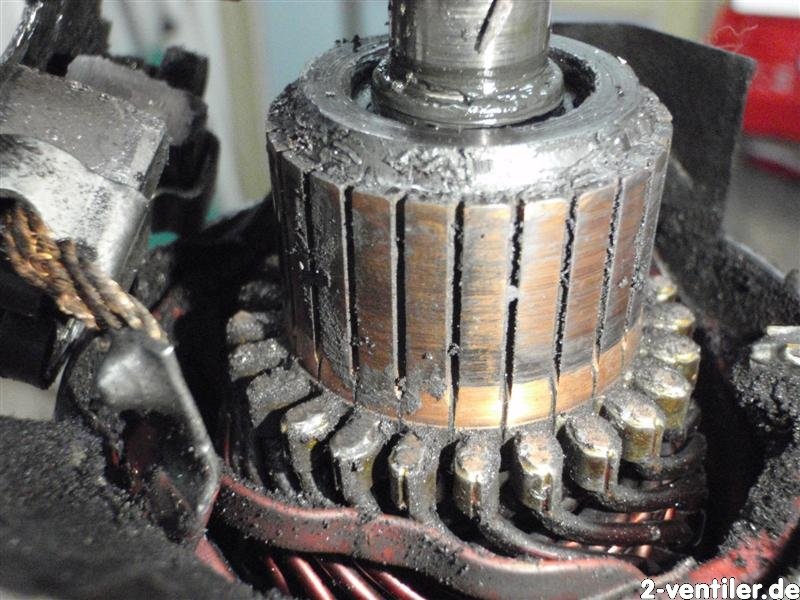

Sounds like an broken starter motor, the brushes for the commutator could be worn out.
The commutator it self could be short and must be cleaned.

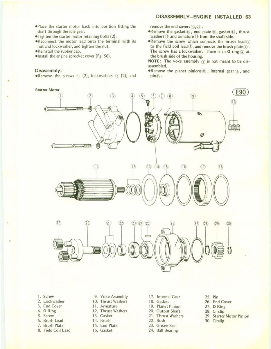

Remove, disassemble, clean and grease the starter motor, It is no rocket science to rebuilt a starter motor.

Im going to redo the starter motor and I will let you know how it goes. Do you know where I can get brushes to replace for cheap?
