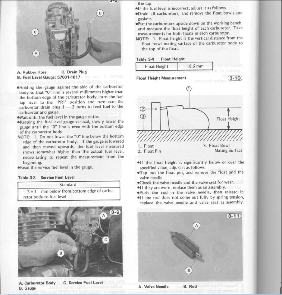

Re: NEED HELP 81 kz1000j power loss at high rpms
11 Nov 2017 15:09
#774463
Check the fuel flow through the petcock and float bowl high.
A clogged filter or fuel line filter cause a low fuel flow and lean the mixture on high rpms.
