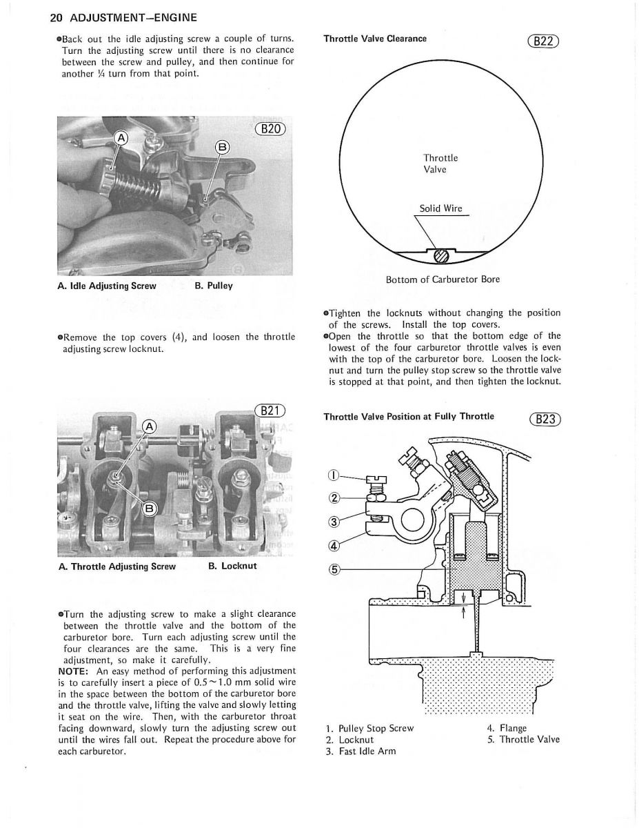

Frenkie S22 wrote: . . . Throttle sliders completely down for sure. . . .
Bench sync may have failed to leave enough threads on the idle adjust screw to further lower the slides.
The slides must often be lowered further than the bench sync setting by using the idle adjust screw.

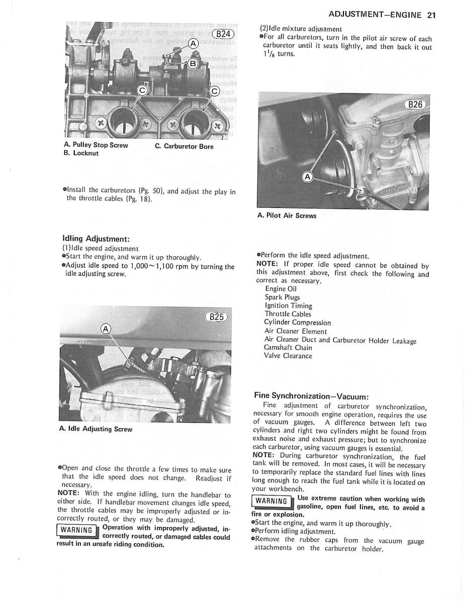

Dear Patton, thanks a lot for your answer - i'll check it out again. I tried the idle adjust screw all in, then either 1, 2 or 3 full turns out. Problem remains by each setting

Try loosening the throttle stop screw, it's located between carburetor #2 and #3.

When you re-assembled the carbs did you adjust the large idle control screw so it was centered? If not, you have no adjustment there. To correct this you can either take the carbs apart again and center it, OR you can simply lower each slide in each carb using the slide adjustment screws.
Also, you can not expect the engine to run properly without any air filter. The mixture will naturally be too lean. Install an air filter or if you cannot find a proper one install pod filters. Ed

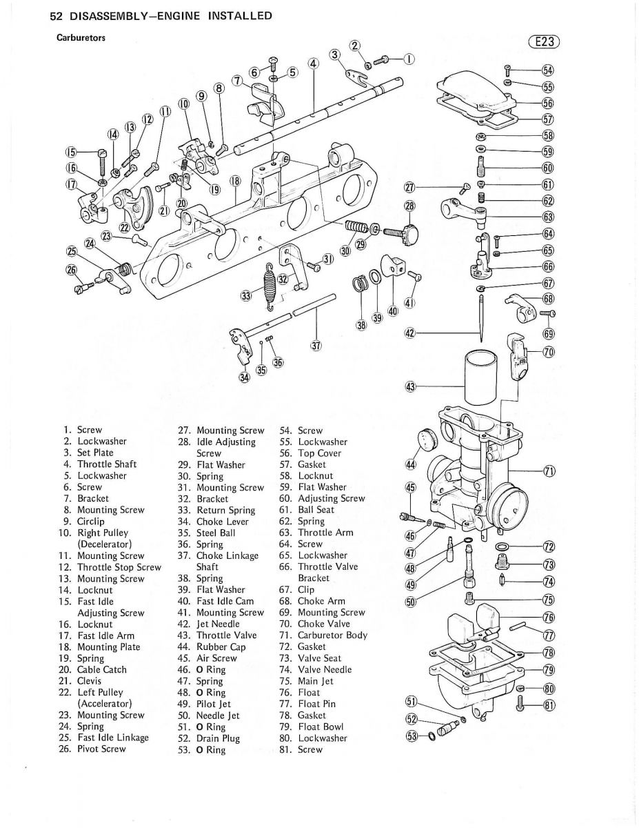

Some pics will help you to locate the adjustment screws

The big throttle screw is suppose to allow you to adjust the idle. It does this by raising or lowering all slides the same amount when you turn it. The fact that screwing the big throttle stop screw all the way out does not lower the rpm is a sign that it was not centered when you assembled the carbs or when you did a bench sync.
You say you can see the slides are all the way down. Have you measured the opening of each slide using a .5 - 1.0 mm diameter wire rather than trying to eyeball it?
I highly recommend you try to lower the slides in each carb by using the adjustment on the top of each slide with the large throttle stop screw set in the centered position. Ed

It takes a very little amount of throttle to make the bike idle that high. The slides may look to be down all the way, but if they are up even 0.5mm the idle will be very high. Normal idle position is in the order of 0.1mm. 0.1mm will look like it's closed all the way, but it's not.
If it's jetted for pods, the pod filters will not make much difference.
The "idle control screw centered" does not really apply to these carbs. There is no key carb. All carbs are referenced from the main shaft.
The idle adjustment knob rotates the throttle shaft, but each throttle slide has its own adjustment (as others mentioned). If one adjustment is way off, it can cause the other 3 to stay open. You should probably pull the carbs and check the adjustments. If you want to "center" the adjustment range for each carb, you could, but that isn't really necessary as long none of them is far out from where it should be. How they are set from the factory is usually more than adequate to give each carb adjustability in both directions.

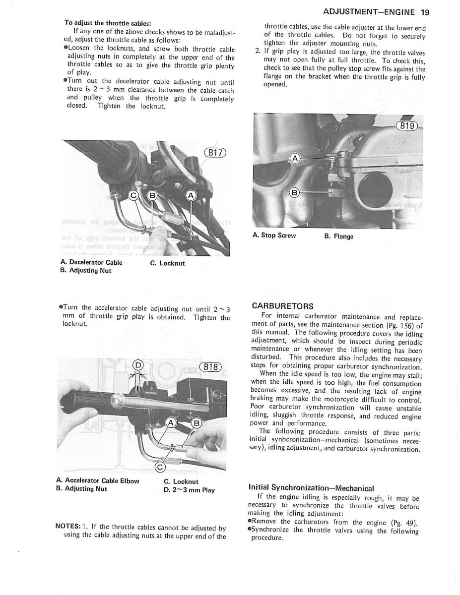

You probably should remove the throttle cables, or at least make sure the throttle cables are not stopping the throttle from closing.
There is a fast-idle adjustment that can also open the throttles a lot if the choke is activated. When the choke is off (lever down) the fast-idle mechanism is disabled.

The four adjusters just need to be somewhere near the middle of their range so they have room to move in either direction for the final adjustment. Then they are adjusted so that each slide is near the same height. To do that, the idle knob can be set to any random position so long as all four slides are up by some amount. There is not a "centered" knob position requirement. Then the individual adjusters are set so all four slides are at the same height.
So it doesn't have to be "centered" but just open by some amount. When the knob is turned out, all four slides should close. If one slide is lower than the others, it will hold the others open. If its by a large amount, the motor will race.
To see the small differences, its best to do this off the bike so you can look into the carb outlets.
That is just the bench sync, and will be inadequate to be the final sync, compared to syncing based on equal vacuum. The adjusters are very sensitive.
