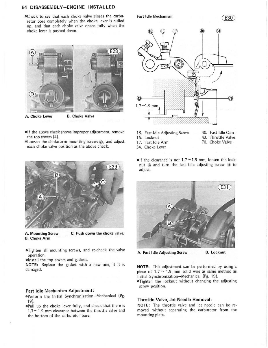

Thank you all for the kind answers. The TK22 webpage is very helpful. That's exactly my carb.
No, I haven't done the adjustment with the 0.5 mm wire - I'll check it out. On the other hand i haven't touched the top adjustment screws with the locknut. The position is the same as before. I also haven't touched the pully and the throttle cables are fully disconnected.
I'm so confused because the bike ran before -- not perfectly - but it did. According to a local mechanic it needed just a good carb cleaning.
Also - I don't want to sound disrespectful, but to me such a 'small' adjustment can't make the engine rev soooo high, can it? I can see the slider sitting on the brass ring around the needle - the needles are also new btw.
Weird thing is that when I started the engine for the first time after the rebuild it did not do that. The float needles were leaking - the overflows in the bowls let gas go out - but than it got slowly worse and worse. As I chnaged the needles the float needles stopped to leak and exactly at this moment the engine started to have issues with high idle. It was like slowly rising to 4000 and then bouncing around that. In the beginning it did run with choke at 2000 rpm (What i thought was normal) but every time I have put the choke down - BAAAM rpm jumped to around 6500 and was rising!
Now its 7000+ with or without choke....

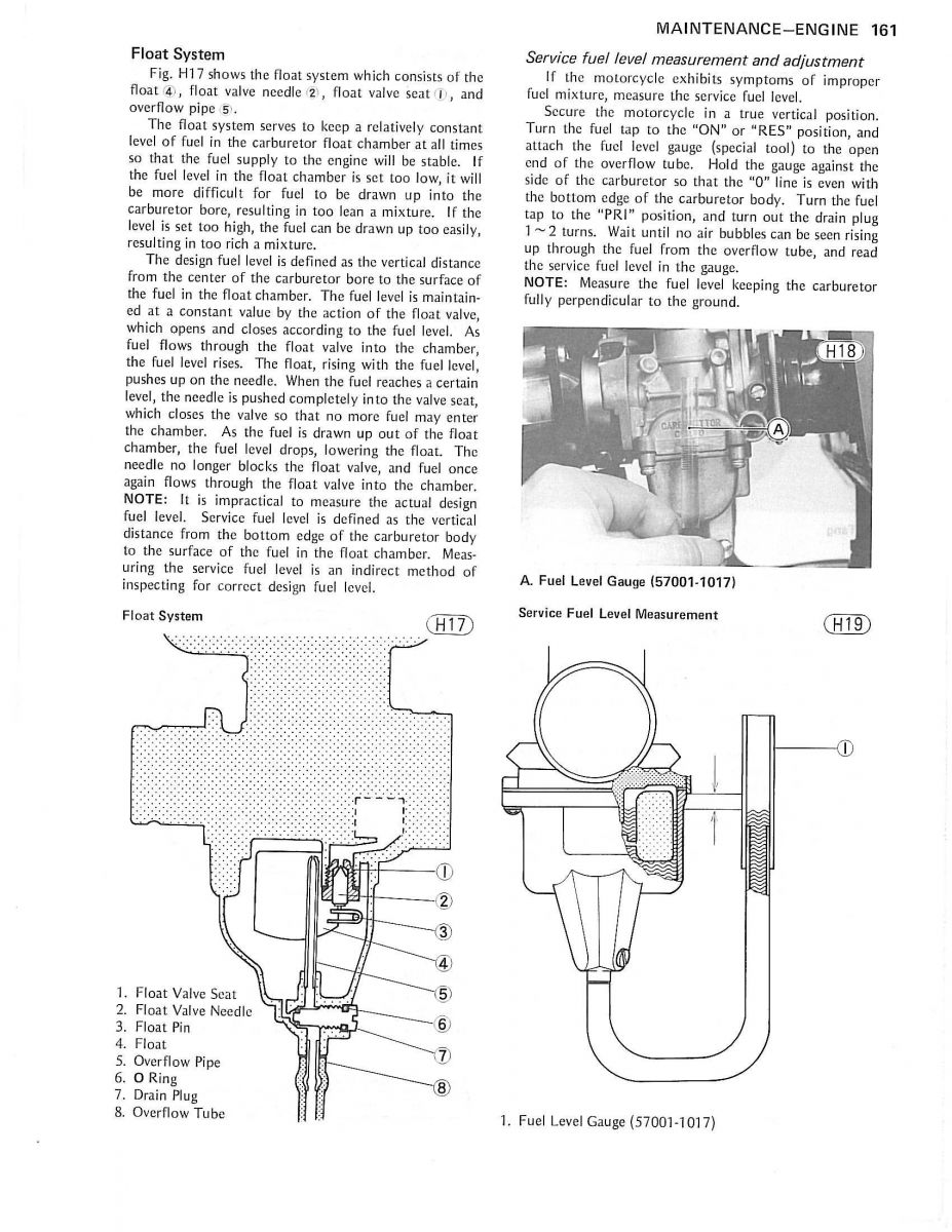

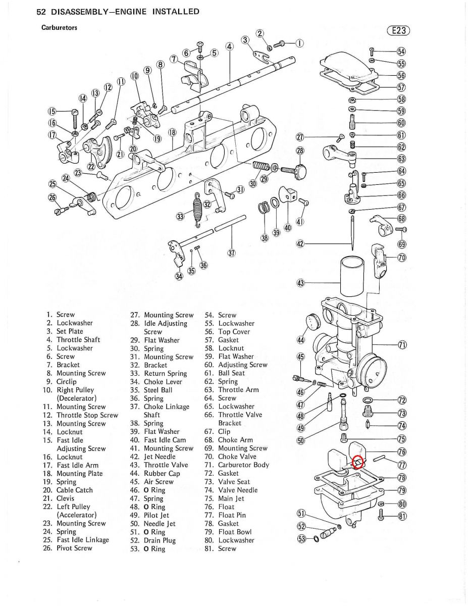

Maybe a lean fuel condition by a low fuel float bowl high AFTER FLOAT NEEDLE VALVE CHANGE:.
Check the float bowl high and if needed correct it with the tang on the float #'76
and be sure ALL jets are clean and not clogged by dirt in the tank (fuel filter?)
No one knows who work with "two left hands" on your carbs before,: I have seen incredible things after/before a carb rebuilt by PO´s.
Some times small things effect a big problem.
Pull the carbs and re-check the internals are clean.

I was thinking about the float height all the time - but wasn't sure if it could cause my issue. I'll check that! Should be 3,5 mm +/- 1 from the edge of the bowl.

Dear everyone, PROBLEM SOLVED!
It was the stupid pully screw! Sorry for telling u that the problem remained - I tried it with choke on which changed the setting to fast idle again.
Choke down - bike runs mint! Adjusted the rest of stuff and took it for the first ride ever today. Man it was such a great feeling.
It was stupid from me to think, that such a small adjustment couldn't be the cause.
Loudhvx you were right. I'll post a video later.
Thx again!
