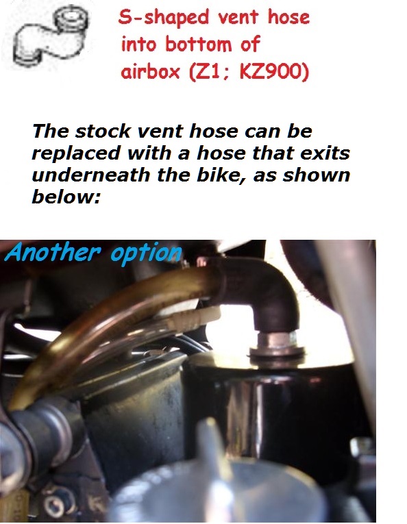

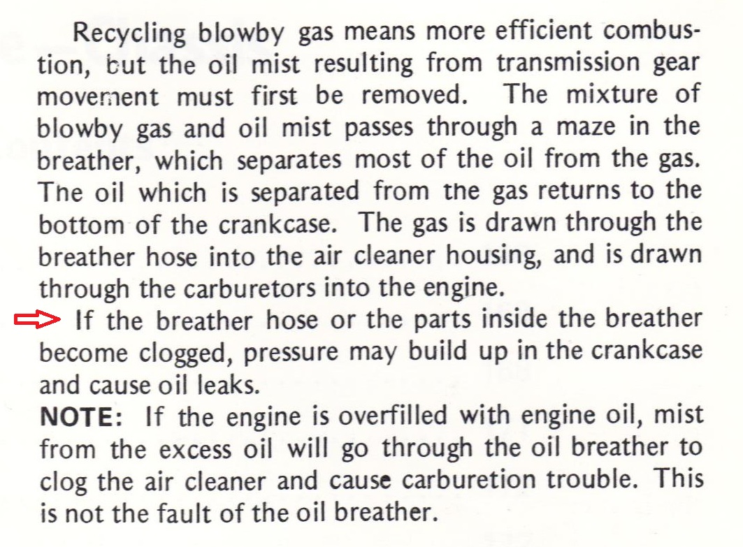

Do NOT driil hole on the oil pump.
Crankcase air pressure escapes through the oil breather.
The oil breather can be removed and cleaned.
Good Fortune! :)

I suspect the OP's native language is Italian, and that there has been an imperfect translation when asking the question in English.
Hoping the OP's concern doesn't involve the possibility of actually drilling a hole into the oil pump. And it might have nothing to do with the oil breather (which was just speculation on my part).
