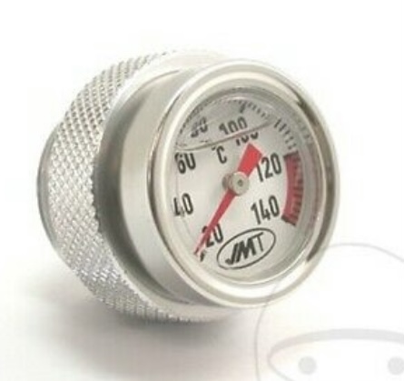

adding a temp gauge, is maybe smart for monitor the temp?

I don't know how effective of accurate those type of temperature gauges are, plus you have to look down at it while riding - not a fan of doing that at all.

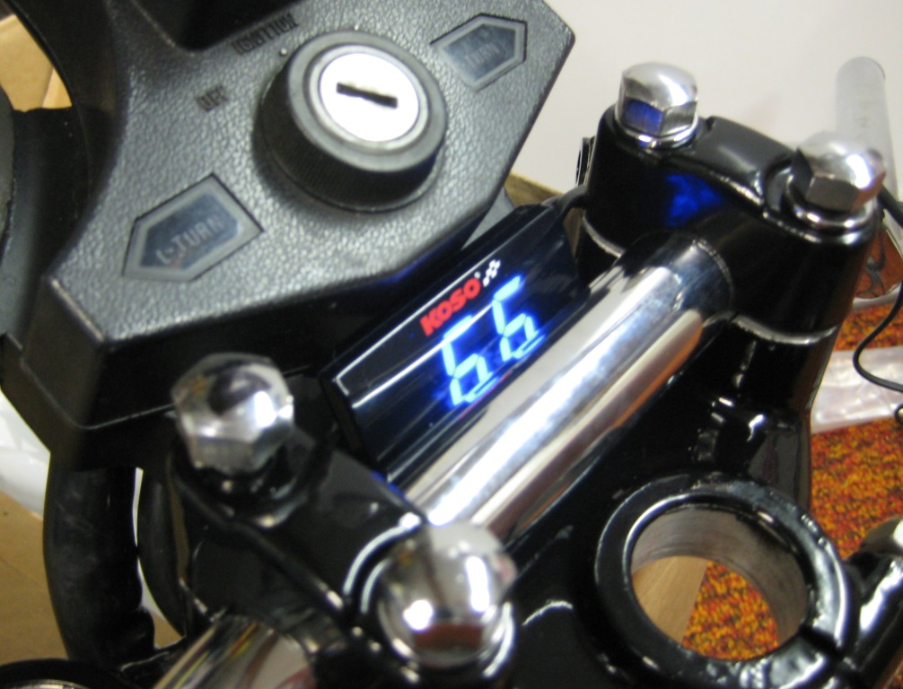

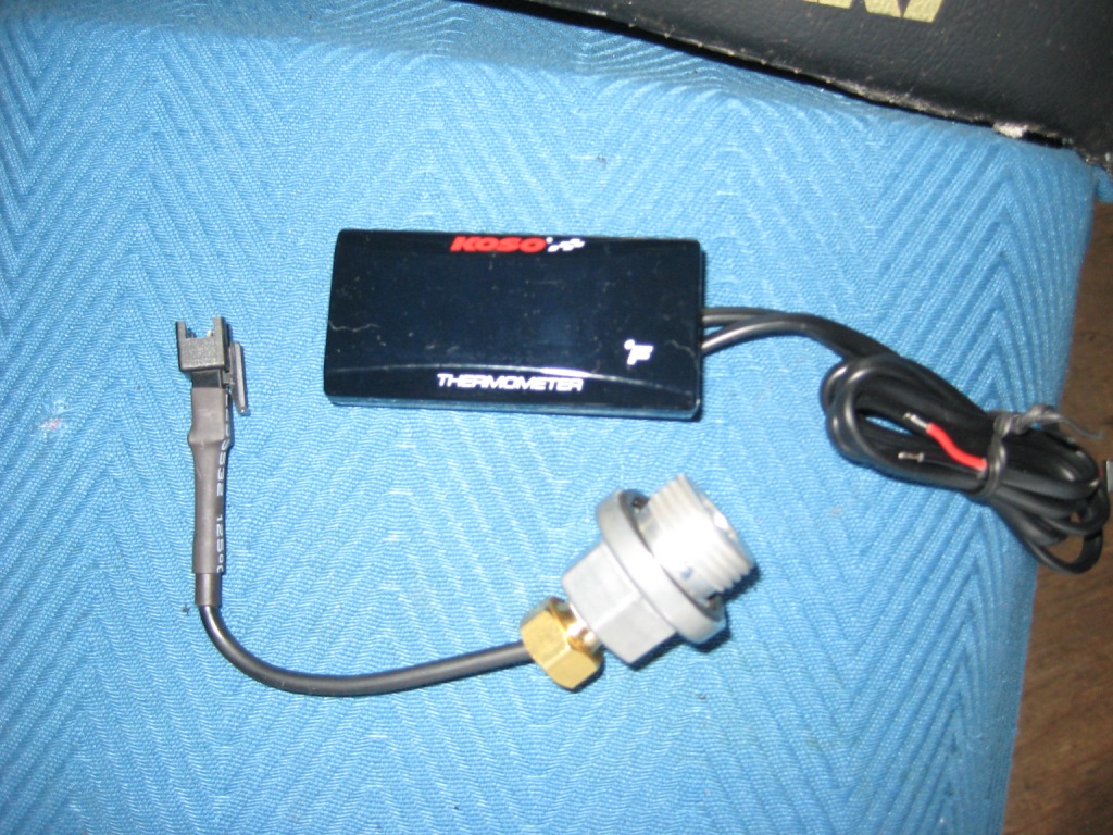

If your concerned about oil temp then there are all kinds of digital temperature gauges out there you can add to your dash/handlebars that would run off a pressure plug and be way more accurate.
Koso brand is one that comes to mind.
