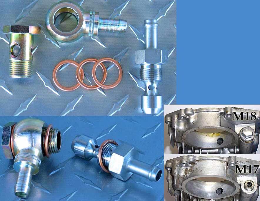

I purchased the M18 kit about 6 years ago for my KZ650. I recently purchased another KZ650 and cannot figure out who I bought this kit from? Has anyone replied to this thread to advise where this fitting kit can be purchased? Desperate and in need, again!

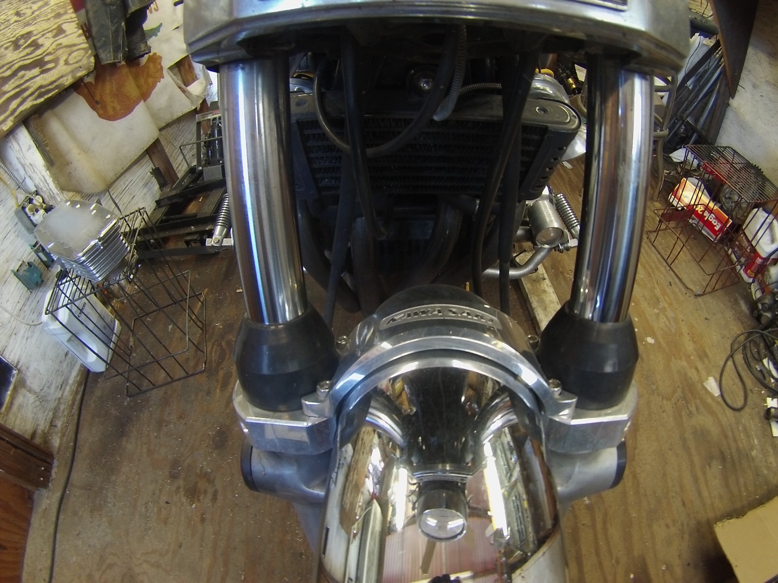

BTW. I installed a 93 ZR1100 (full sized) external cooler with this M18 fitting kit. I have roughly 12k miles on this set up, and this bike is my daily driver. I also installed an Off The Shelf Temp Gauge that is commonly mounted in the Oil Filler Hole. I expected that this Oil Cooling solution would bring down the typical operating temperature. I can say that this was not the case. So, the before and after operating temps are the same. The benefit has been that there is an additional ~1 qt of oil in the system. This means the oil is not quite as spent/degraded and I can run longer between oil changes.
I understand there are several different ways to plumb the system. I did not do a deep comparative dive to test multiple setups. It's possible that there is a more efficient way to route the oil to actually reduce oil temp, but I am content with this set up.

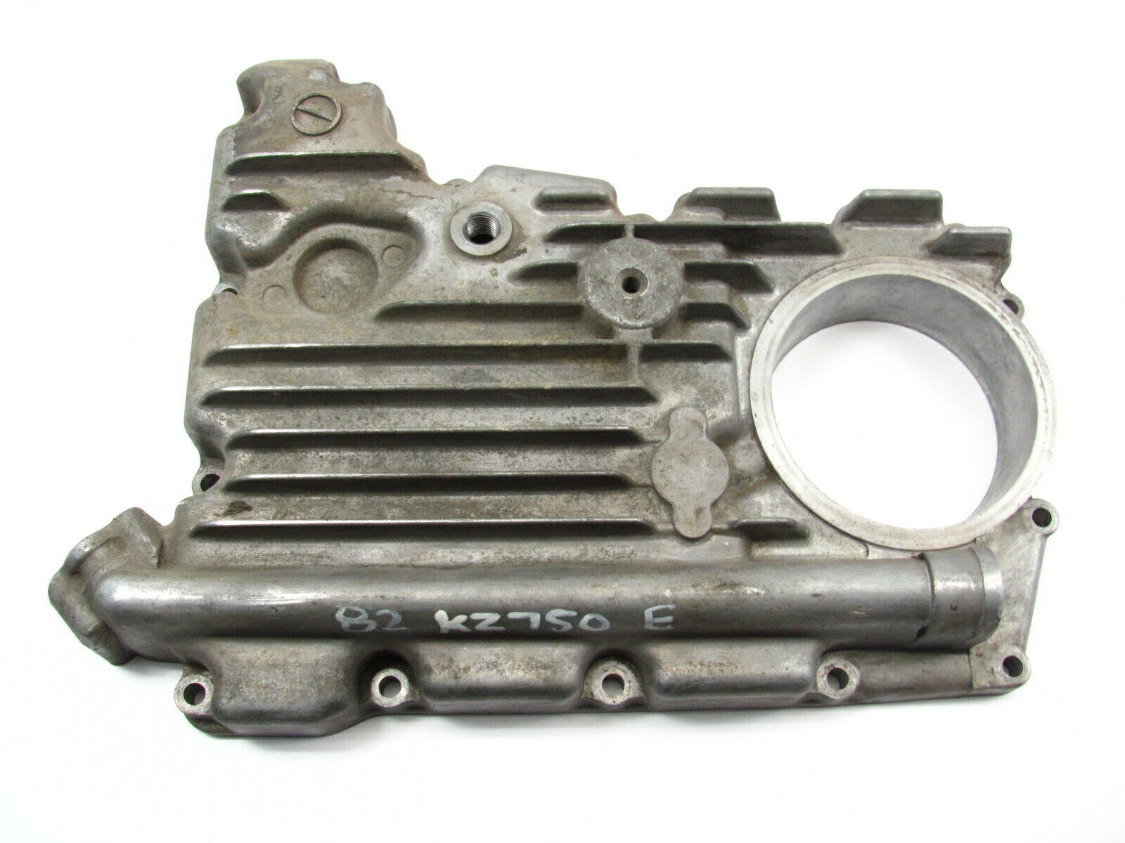

07 Apr 2022 05:10I bought a pan from a 1982 KZ750 E, it has the oil level sensor hole as cast so no chance of leakage. The oil ports on the front lug are not drilled either so you can drill your own for 1/4NPT to -6AN, just need to tap for a divider plug.Thanks for the feedback. In my case, I have the engine out on the bench currently so this is a possibility. For the owner that has the motor in the bike...not so appealing. I will check into some OEM exploded view drawing and explore this a bit deeper. Thanks.

you can get M18x1.5 AN fitting adapters for the back of the oilpan and the main oil galley and run an oil cooler between the two. I would get a dual side exit oil cooler and run both AN lines down the right side of the engine to the oil pan and main galleys. See my turbo build thread.
