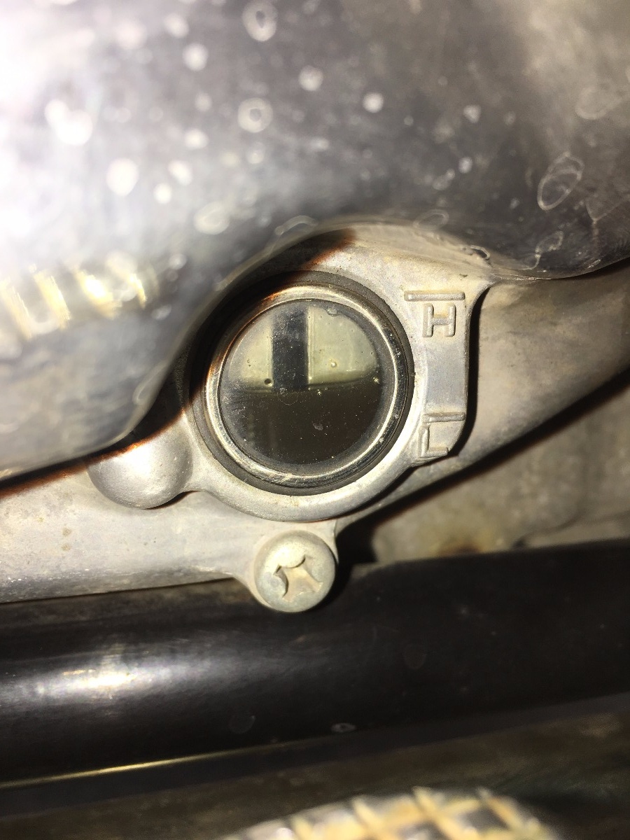

There is only 20 miles on the bike since the oil change but, to me, the oil looks a little opaque. There is a photo attached of the oil through the window. There is an appropriate amount of oil. its not over filled.

I'd ether run a tube up then down to the chain or install a fitting for the airbox. That filter may be too small for the bike. Oil looks normal and it should clean up after the next oil change. If the valve guide seals are old and hard, they will let hot exhaust gasses enter the head/crankcase.

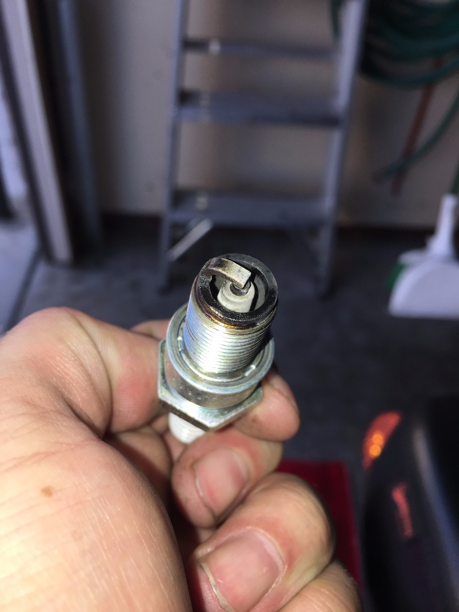

Just checked the plugs...
The right side looks normal but the left side has developed a bit of oily blackness around the base. It was clean yesterday and there have only been 15 miles driven on it today.

Looks like valve guide seal. It might clean up as you run it. Might be time to gather gaskets etc. to change them in the future.
