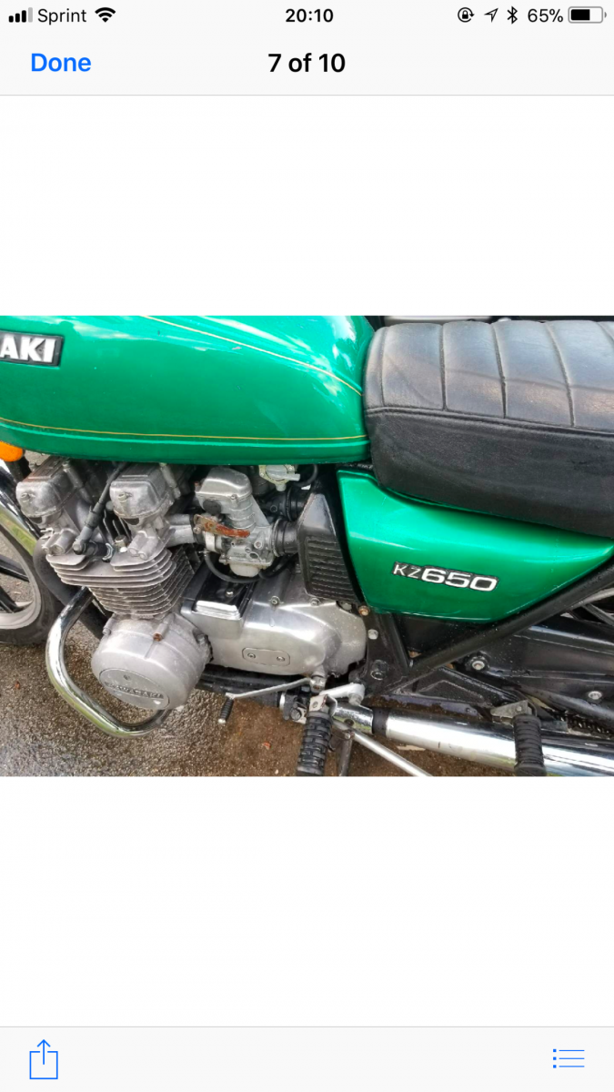

Here are pics. Anyone have any foolproof ideas of how to get the oxidation off the engine (its grey and lumpy)?
See pics:

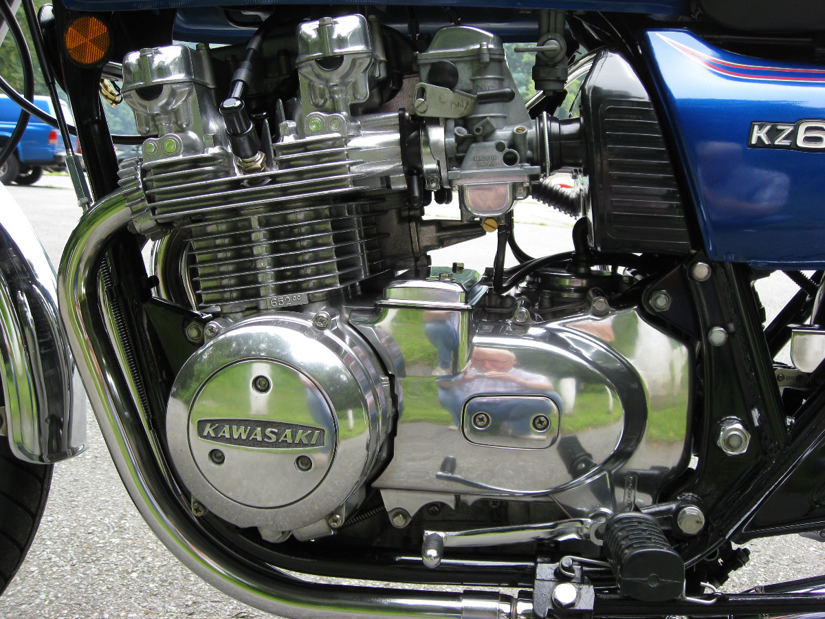

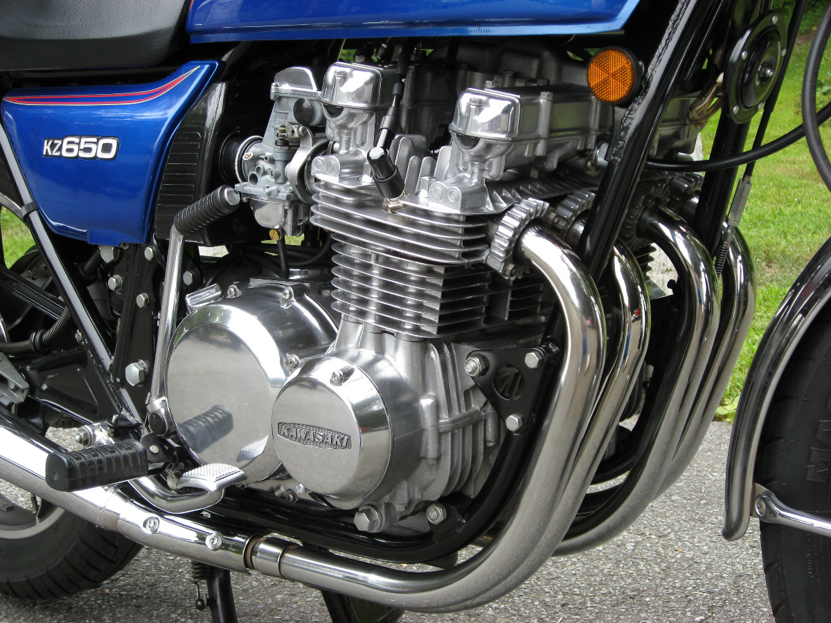

I've gone over my covers with 400 and 600 grit over the years with water and a few drops of soap then followed up with Mothers polish.......... recently found hitting it with 1000 then 1,500 grit lastly really helps bring the shine out before hitting it with polish. Ed uses a couple of products I'm sure he will chime in on and you can't argue with his results but since I've had the Mother for years I was too cheap to switch.
Just was a thread on sealing the shine in with clear coat and there is a lot of sealers out there too but I'll probably just plan on hitting them once a month quick now that I've got em pretty nice. My head is still very good and since I have painted the block black for years I don't have to worry about that hard to work fin area........ Like that green (the darker green too) please be sure to give us some pics after you get it shined up.
