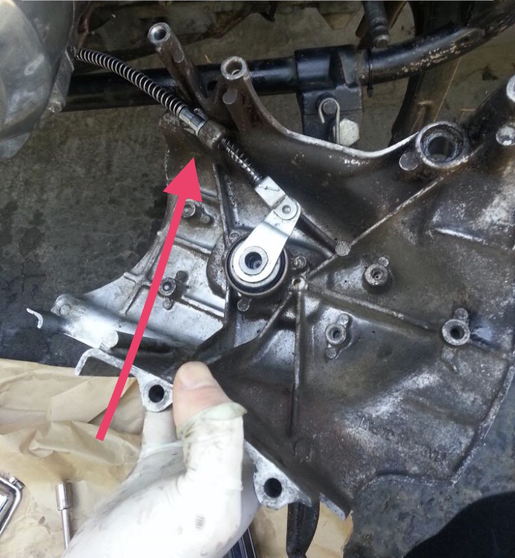

If you can if fact still see the ball bearing still in the transmission shaft that the pushrod runs through, then the issue lies with the pushrod actuator or clutch cable.
The ball bearing and clutch throwout plunger can't move or just fall out. They can only be removed by taking the entire clutch apart. So it can't be them.
With the pushrod actuator properly adjusted as well as your clutch cable, then I might suspect you forgot to reseat the clutch cable back into its perch in the sprocket cover. If not done, you can squeeze the clutch and nothing will happen.
Clutch cable perch. (Borrowed picture from a member of this site.)
FYI, I don't think you can release the clutch pressure plate by simply pushing on the pushrod by hand. The pressure plate springs are stronger than you think and you would more than likely knock the bike over before you released the clutch. It requires mechanical leverage to budge that pressure plate.
Food for thought.
Food for thought.
