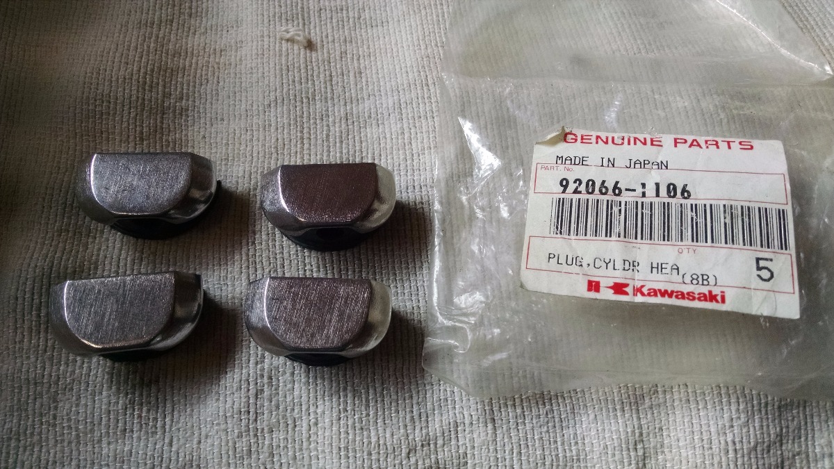

These cost me almost 60 bucks, and finding the OEM part was not a easy thing.

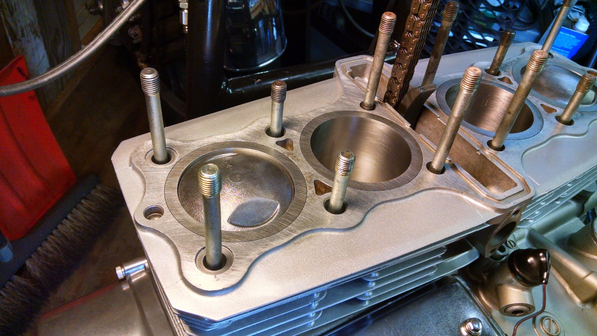

Here is the block cleaned up with just copper anti seize compound on the studs. I also put a drop of 30 wt ND oil in the head nuts and also oil the washers, so the anti seize is not the only lubricant on the head fasteners.

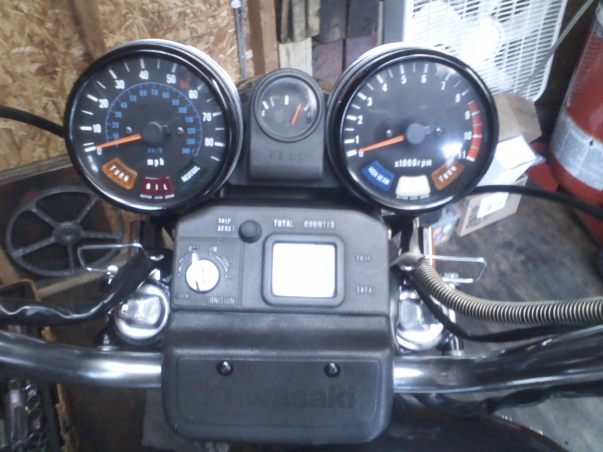

25 Sep 2017 23:19 - 26 Sep 2017 10:06WOW, that is freakin NICE! I don't care for the 85, but it's what came on it. The speedo and tach are both electronic. The tach is kinda flakey around 3K, (jumpy) and I am about to wear the pointer stop off of the speedo.
With most, there is always someone reproducing these restoration parts.. I assume not for cheap.. My silkscreen lettering is worn off of the gauges, not nice and pristine like yours. And I consider my bike in pretty good condition for its age.

That 160 gauge was an incredibly fortunate find. I still consider it the perfect icing on the cake project for my bike.
Never even new they existed, except for some long-forgotten fairy-tale I dreamed of years ago.
Complement appreciated.
BTW, your gauges look great. The tach-bounce might be just be a loose wiring connection under the gas tank. It doesn't hurt to wiggle the wires once in a while.

Nope.. the tach jumping is mechanical, and is internal to the instrument. WHen I first got this bike running in 2013 the tach wouldn't go over 2500-3K rpm. I took it off and short of mangling it in order to disassemble it, I found that I could get the the pointer to jump by blowing compressed air into the lighting holes in the back. It is also off a few hundred, but not bad.. as IF either of those gauges ever caused any of up to unwind that thing on the right.
