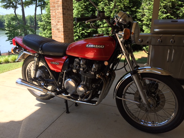

Question,
I've been on some of the Kawasaki micro-fishe parts look ups and trying to see if there were any differences in exhaust on the Kawasaki 650 line up between 1977 and 1980 ,, I get conflicting info on the sites. . Were the KZ650's the same as the later SR650's, Custom's etc .. They all look similar.
Mine is a 77 KZ650B and has a MAC 4-2 system (to loud) however when I bought the bike the prev. owner included the factory pipes which look good, however in the left muffler a baffle inside must have come loose about mid-way down the pipe and moves back and forth when you tilt the exhaust (glad I learned this before I put this back on the bike the rattle would have driven me crazy) .
Any info would be helpful.
Thanks
Thanks

Wow,
Thanks you for the detailed info. There is a complete system (really nice) on e-bay for an 80 SR for $600 bucks , however thanks to this info I now see the differences , can't believe I did not spot that criss-cross!. Guess I will just be patient until a decent left side muffler for a B,C,F shows up somewhere. Currently most of the ones on e-bay are junk.
The MAC system on the bike looks great, just to loud and no optional baffles to quiet them down (probably would have liked it at 18).
Any other options? Really want to keep it stock as the rest of the bike is !
Re: KZ650 Exhaust Systems
25 Sep 2017 07:06
Your bike looks great! The paint on most of the red KZ650-B1 bikes faded very quickly; yours looks like new! I’m very glad to see you plan to keep it stock. There aren’t many stock ones left, but to me the stock ones always look the best. Ed
