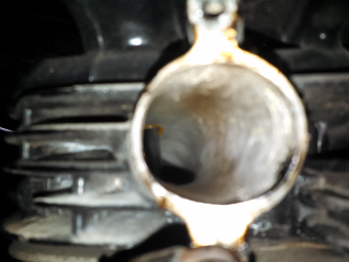

Hey Oldschoolkz1000, it's worth noting that the picture of your bike shows a valve cover that does not match your engine serial number. You should have the Mk2 valve cover, but you have a pre-1979 mk1 cover. It's possible that your bike has a head from an earlier model. The only real difference I'm aware of is air-ports for emissions reason.

It is very possible, the engine has been heavily modified. By who and what exactly, I don't know. I do know that it is a 1480 and has been ported.

Cut off the valve guides too. What cam does it have? I was thinking it could be detuned a bit for the street.

I don't know any of the current engine specs other then it has a 1480 kit and N.O.S and porting, which I found when I took off the carbs.
