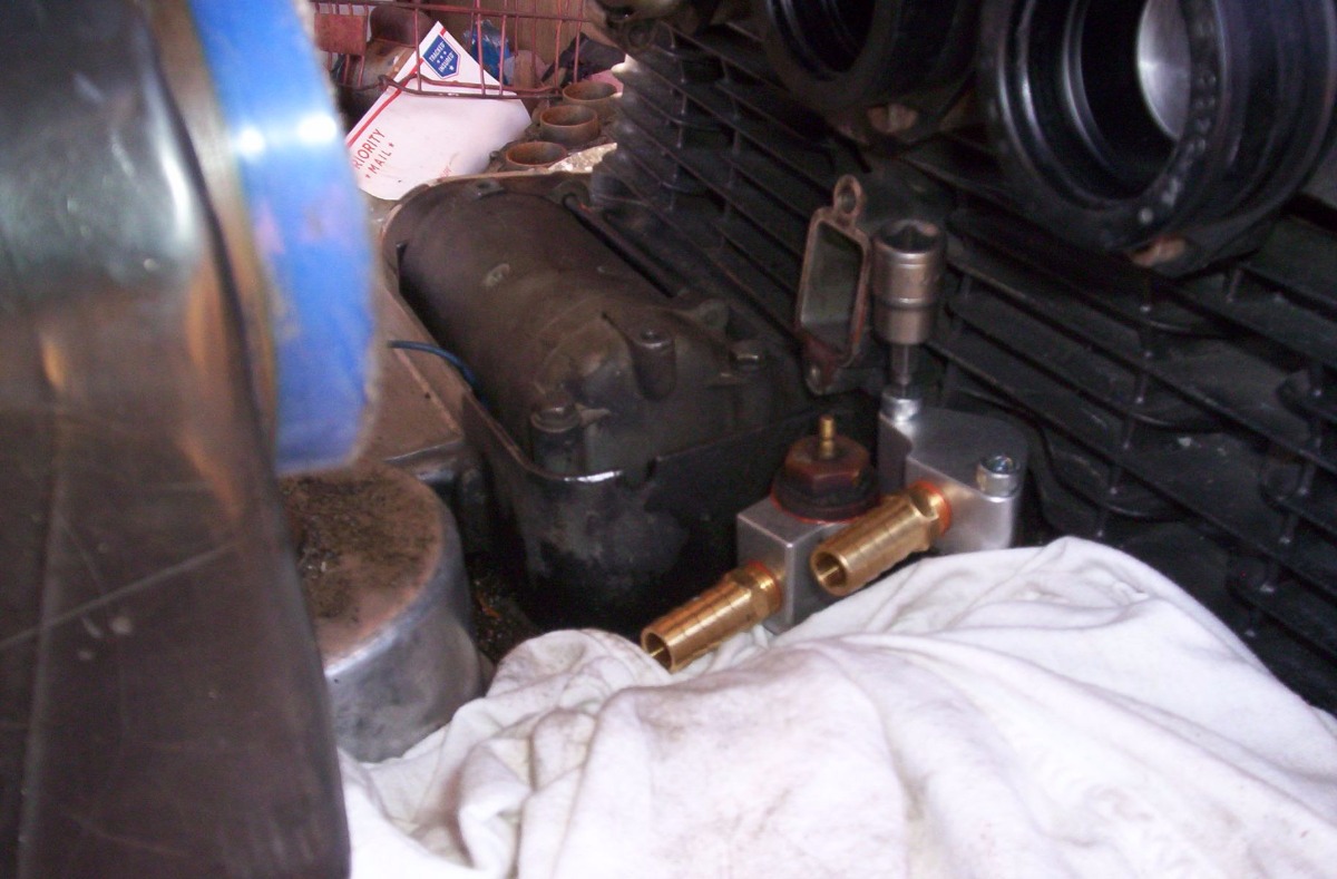

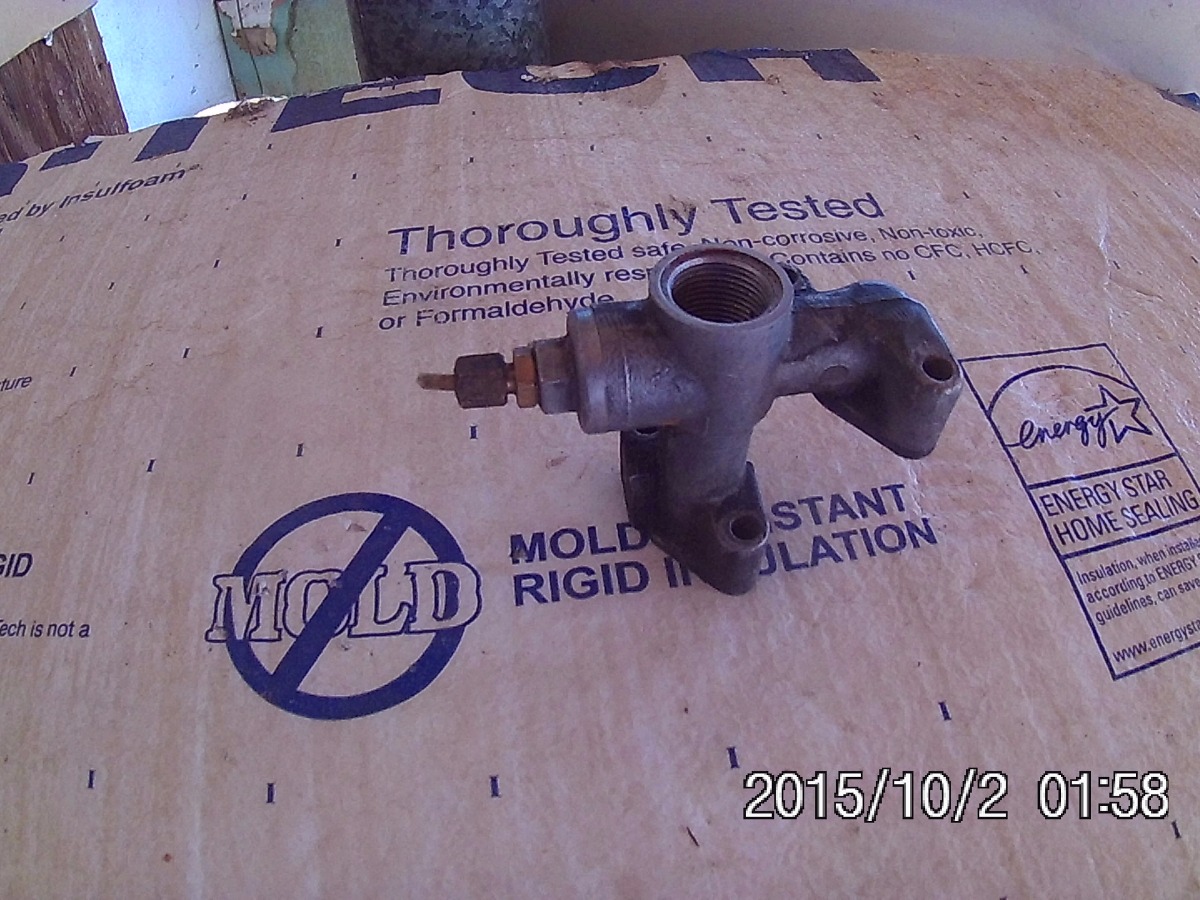

Before I got my cooler setup I had this. There's a tap on the riser under the oil pressure switch.

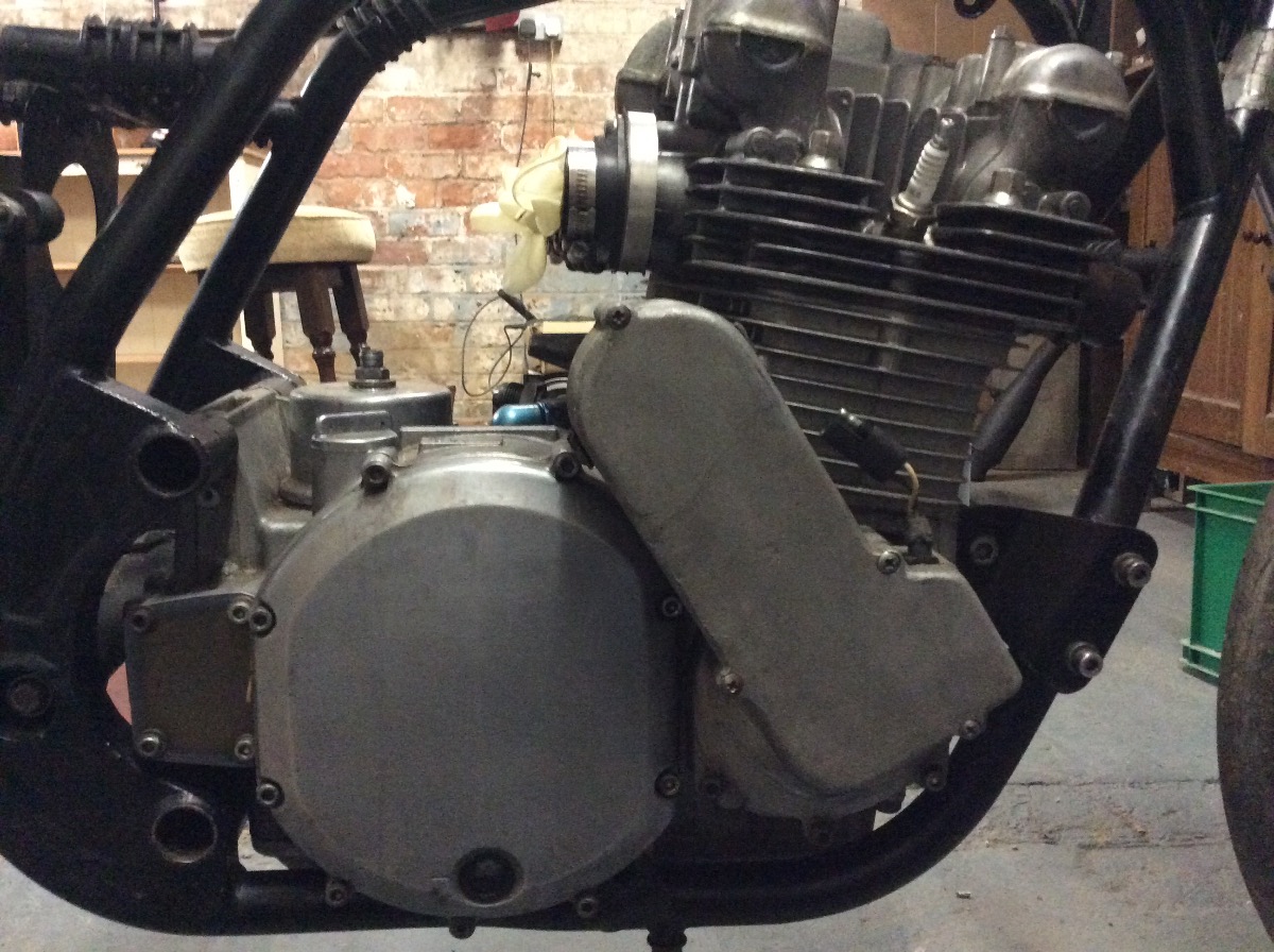

I'm running an oil cooler,this is my set up. I didn't think a guage would work correctly on a 10-12" pipe. Would a tee off the oil cooler line work?

Those fittings look way too restrictive. What is the ID going into the blocks? The lower end gets the oil first then if the volume is enough the cams will get what they need.

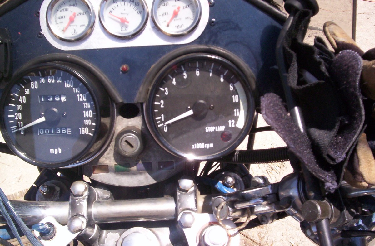

Just asking here, but why would you want to run a full time oil pressure gauge, instead of an oil temp gauge. If psi is being checked used for testing purposes, I can see why you are doing this.

Re: Cam problem
23 Sep 2017 06:32
It's comforting to know what the oil pressure is and in my case the head temperature. I thought about putting another tap on the cooler line to monitor the oil temp but like this better.

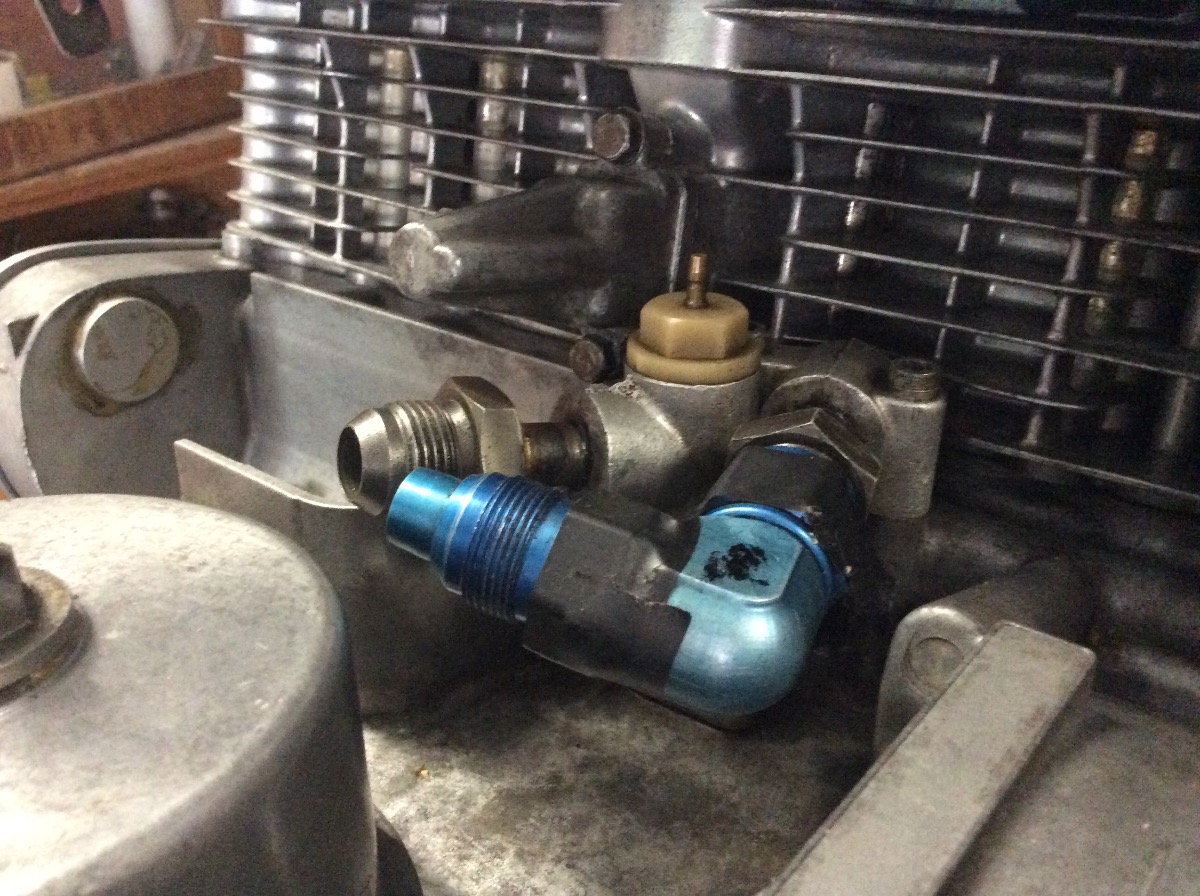

Re: Cam problem
23 Sep 2017 16:04
I shot this clip while I was doing my carbs with this thread in mind. When I installed my cooler blocks I tried to keep the ID's at least 12mm. Most are 13mm. Being the oil has further to go I didn't want any restrictions. This is what I came up with for the tap and Temp. gauge.
