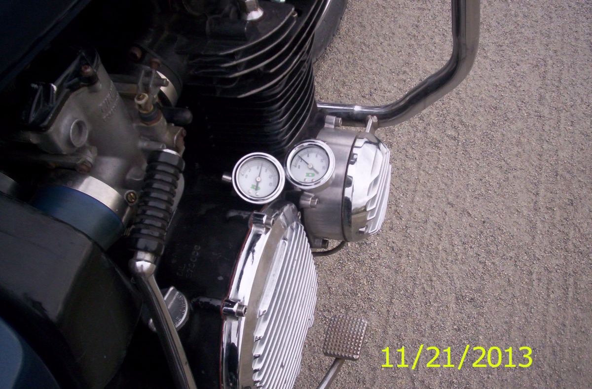

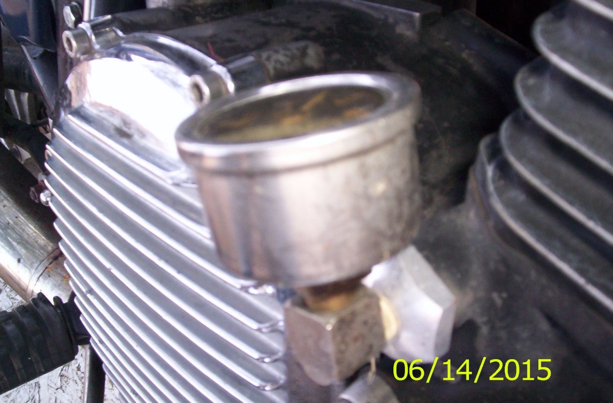

Has anyone got a picture of where to fit an oil pressure guage?
1983 kz750 F1 Ltd Shaft US model
Re: Cam problem
19 Sep 2017 07:27
- Pipes66
- Posts: 68
Re: Cam problem
19 Sep 2017 12:22
Thanks SWest,
I guess that's a job for when I split the cases.
Re: Cam problem
19 Sep 2017 13:08
You can just drop the pan.
