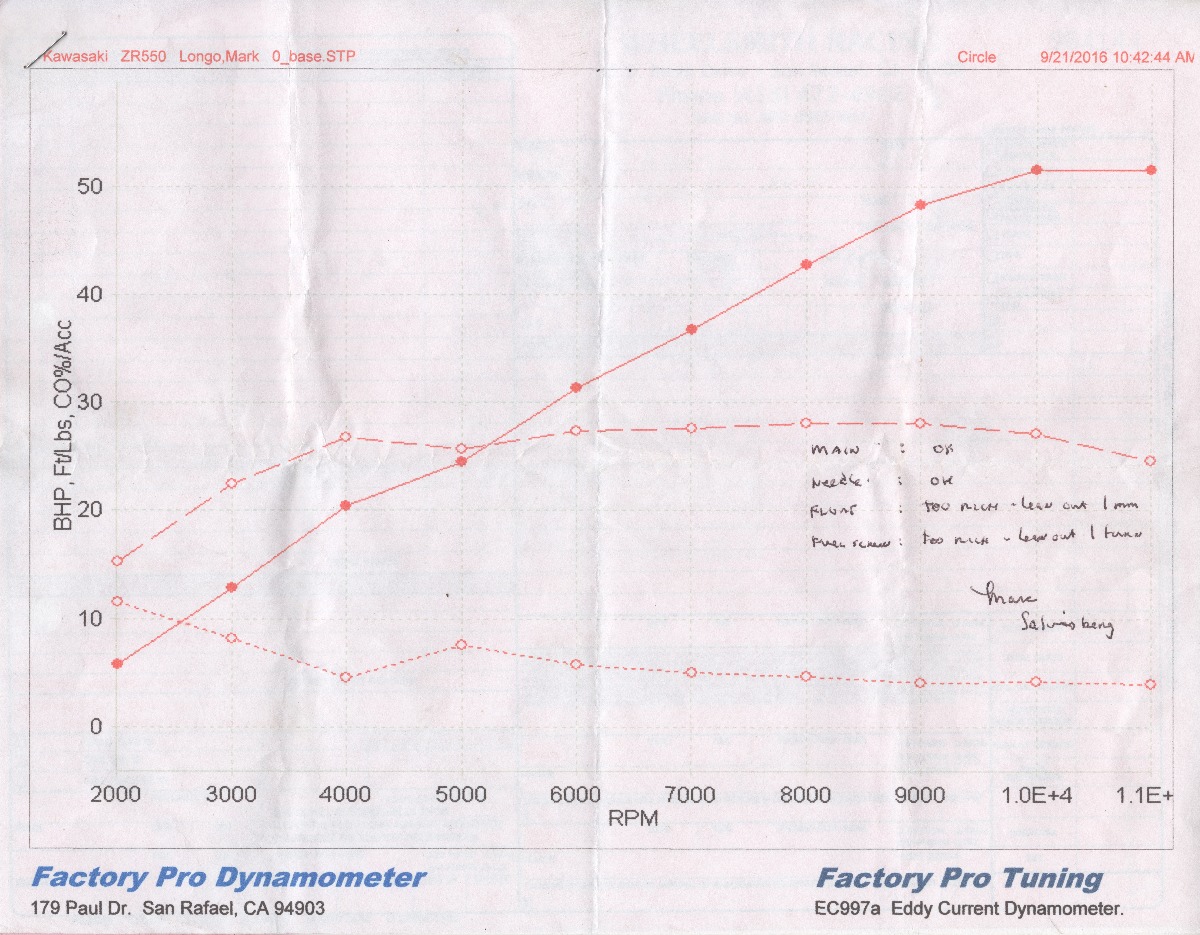

I started taking my 550 to the track. It's been pure adrenaline Zen. My bike is making lots of power on the high end, to the point where I'm finding myself regularly pushing beyond the 10K redline, up to 11-11.5K.. I wondering how bad it is to go past redline in general, and if it's not so bad, can I go even higher? It's still pulling super strong at 11K rpm.

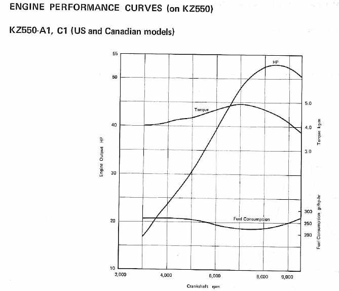

Contrary to what you may think your bike isn’t making decent power past redline – just noise. Take a look at the chart below and notice what happens after the engine reaches 8,500 rpm. At that point power begins dropping. By the time you reach redline it’s making less power than it does at 7,500 rpm. If you were to extend the line on the chart you would find the engine makes less power at 11,000 rpm than it does at 5,000 rpm. Guys who race successfully have learned to keep the revs at or near the top of the power band, and that is not above redline. If you doubt the chart spend a few dollars and put your bike on a dyno. It will verify the info in the chart.
Over revving the engine will kill it. A guy on KZ650INFO stated that he often revved his KZ650 up to 11,000 rpm. I mentioned that this was destructive, but naturally he did not believe me. After a few weeks he reported that his engine was dead because the pistons and valves had struck each other. He suspected the rods had stretched to the point where the contact was made or that the valves simply were not closing quickly enough due to the stock valve springs. He never verified the cause and never got the engine running again.

Thanks all. The sprockets are stock as far as I know. I'm running Castrol synthetic and change oil every 2-3K miles. Only major mods are a Kerker race exhaust (1.5" competition baffle), Factory Pro Stage 1 jet kit and K&N filter. Here's the dyno. Looks like hp is peaking around 10-11K rpm with torque just starting to fall off.
My understanding is that the main risk is valve float and that if that gets bad enough that pistons meet valves then the engine is toast. But before then, as the valves just start to float, there should be a loss of power. So I'm guessing that I'd get a "warning" of loss of power before catastrophe...or maybe that's just wishful thinking.
