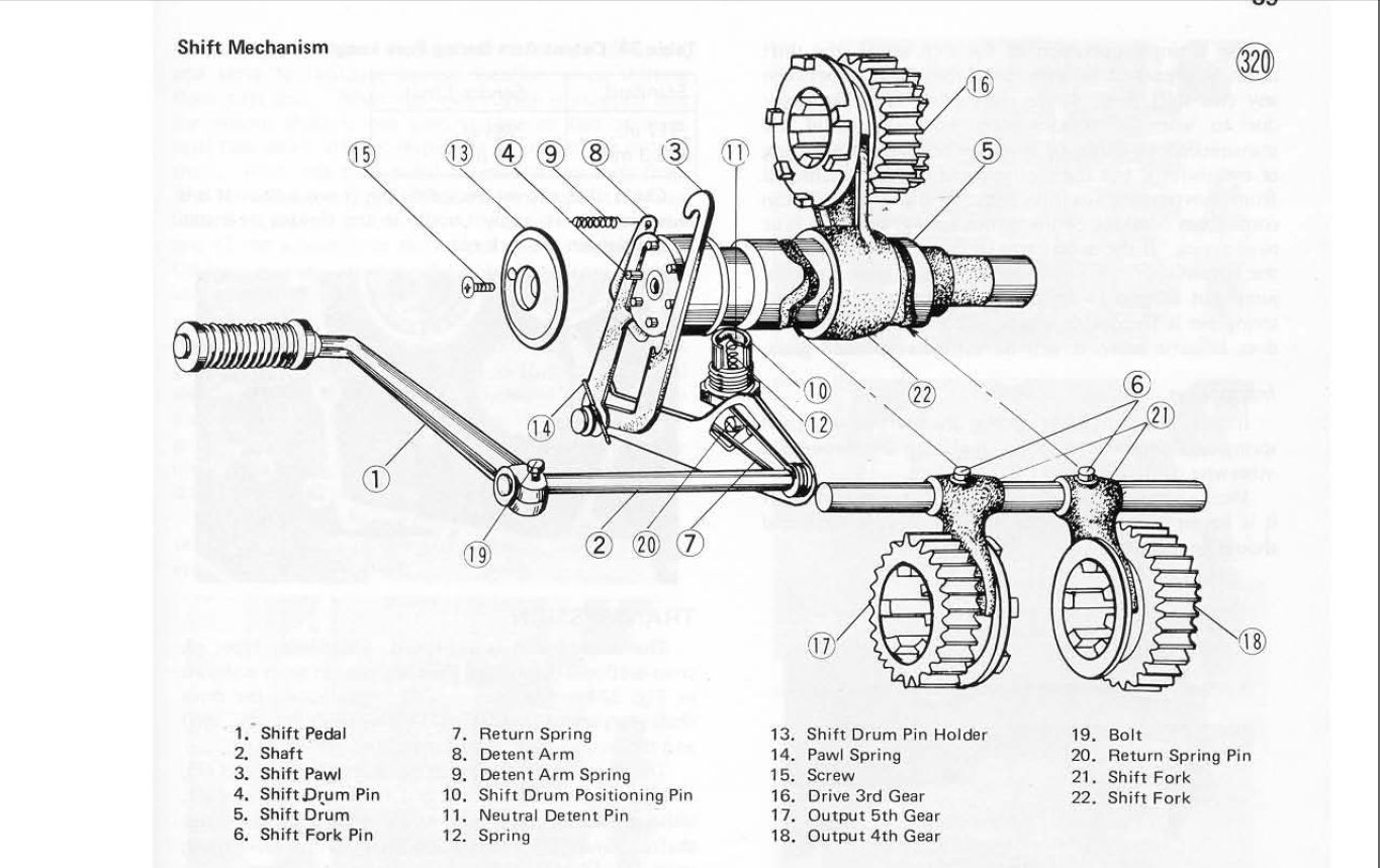

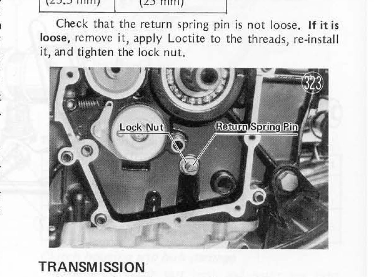

Could be a broken returning spring or a loose or broken returning spring pin
It is located behind the transmission cover. In very rare cases the pin is broken out off the casting of the engine housing.

+1 on Scirocco's suggestions.
Also, there's a service bulletin covering early Z-1's regarding the return spring being too long & binding. We'll have to look it up & post it later.

We were wrong; there are two service bulletins re: shift lever travel issues on '73's.
Apologies for the poor quality. These are probably 3rd. generation images. Best we could do.

The return springs were weak. Two winds. Get one for a KZ 1000. They are stronger. So is the main shift fork.
