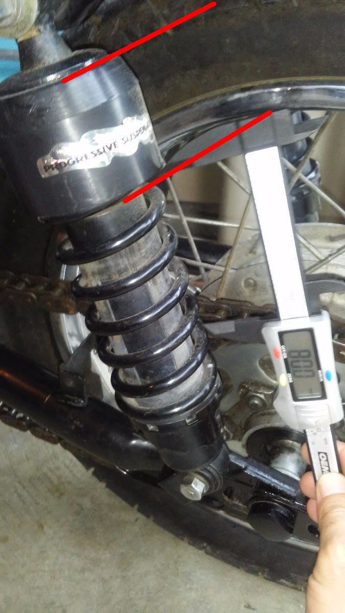

I thought so.. Maybe not? They have a sticker that says progressive suspension
Southern Maryland
Re: Kz650 kickstart help
21 Aug 2017 16:16
A sticker says nothing about the stroke, it is an incentive to buy cheap crap.
Ask 650ed for his length of his unloaded rear shocks.

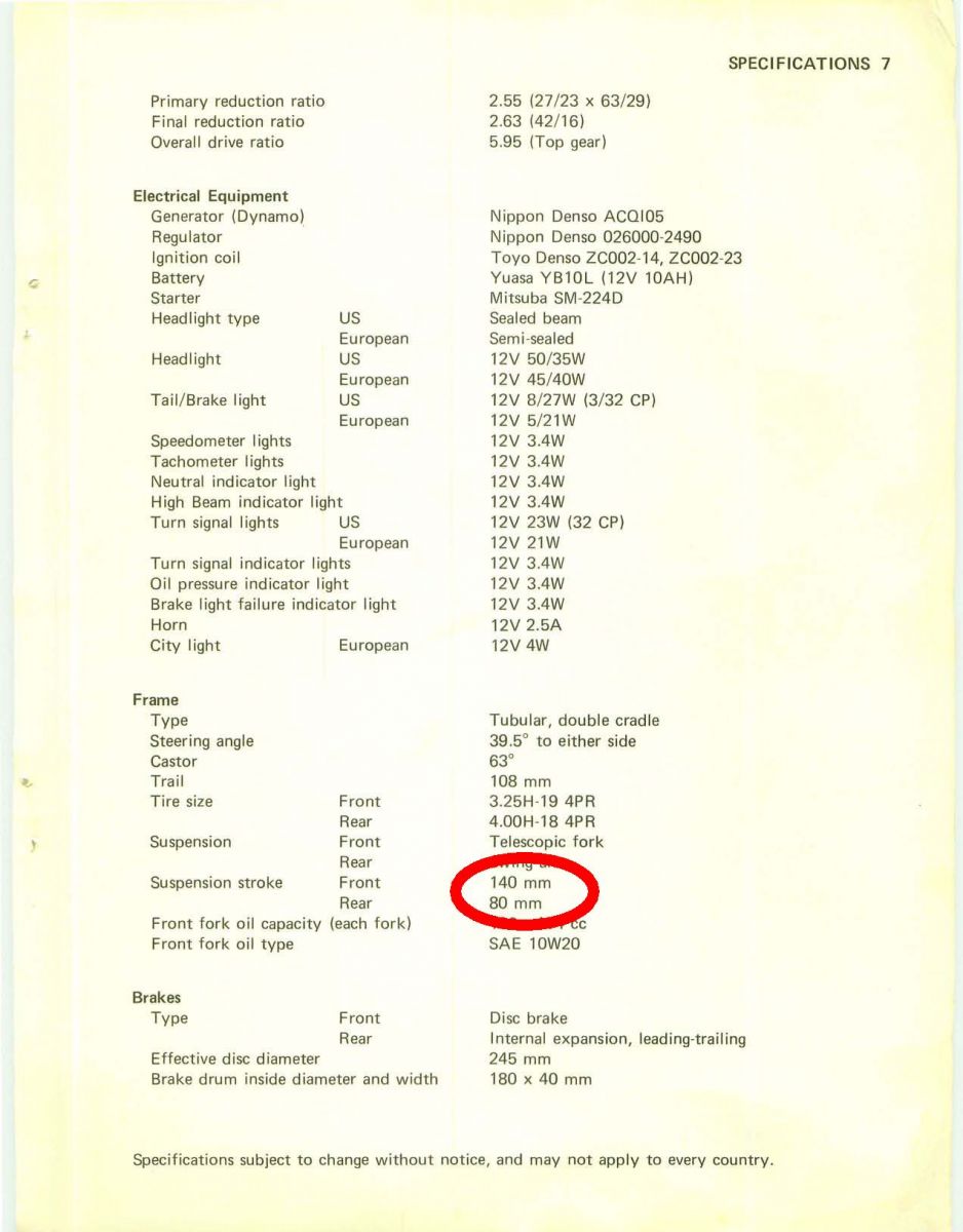

Thats 80mm so what exactly am i measuring?
Southern Maryland
21 Aug 2017 17:07 - 21 Aug 2017 17:23
This is your stroke length
. If under plastic cap is a rubber limit stop you have measured this length, (the red line in the middle).

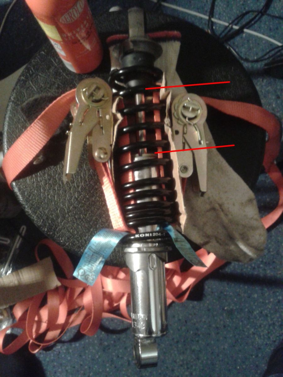

My rear shock for comparison
You have to lift the bike to get the rear wheel from the ground to get the real stroke length..
The unloaded over all length of the mounting grommets made the necessary shock length for the right wheel to frame clearance..
Keep in mint, some shocks are build shorter or longer with the same stroke length..
