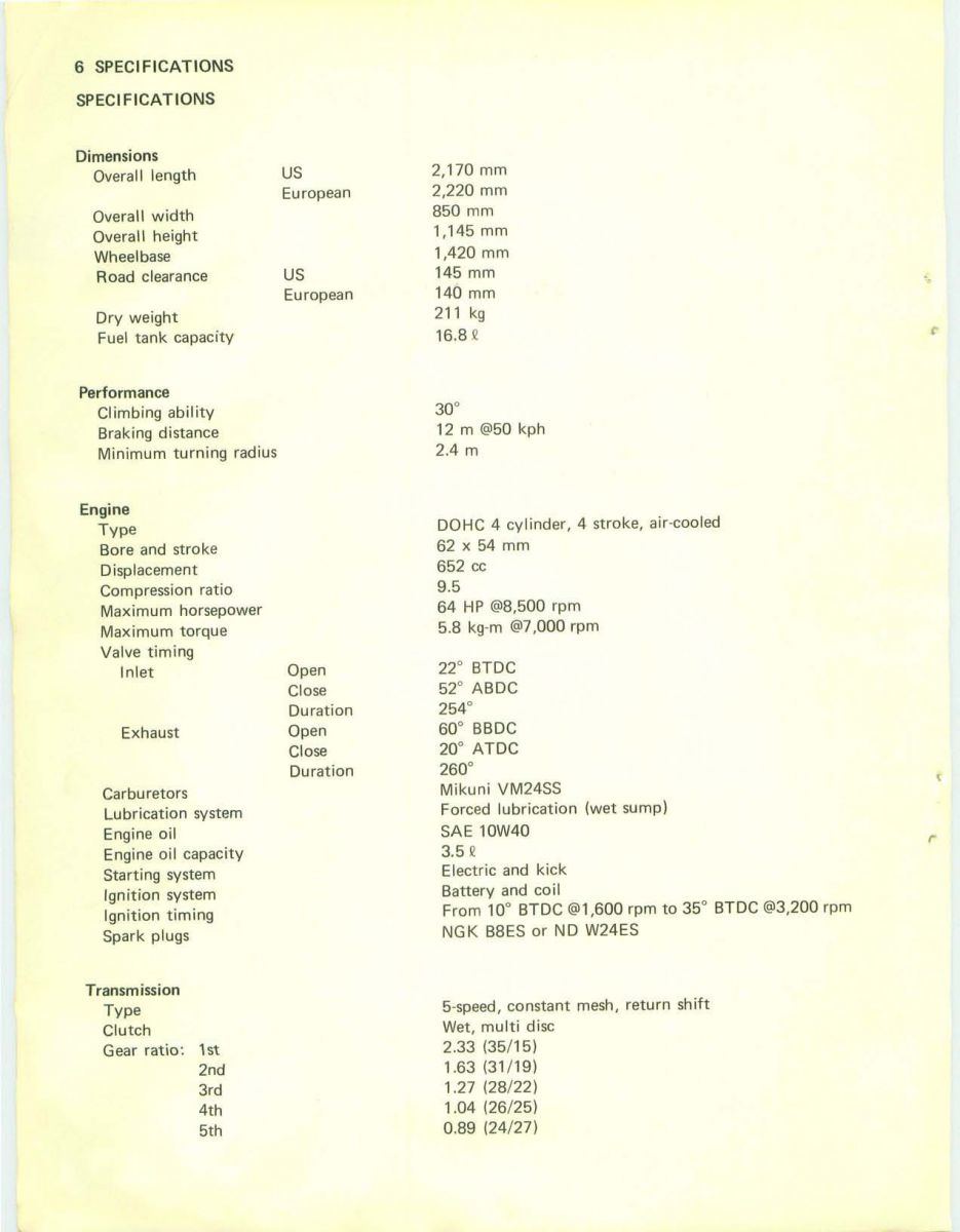

It look like your specialist mechanic overfill the engine with a lot more oil as necessary.
Out of my memory 3500 ml = 3,5 Liter = 3.7 Quart (USA) = 0,925 Gallon (USA)
The view glass in the clutch cover have to show half filled with oil when the bike is on the main stand.
Be careful your engine sucks oil into the combustion camber over air filter body.
Liquids can“t be compressed like gases an will destroy your engine (Piston cracked and crank rods bend)

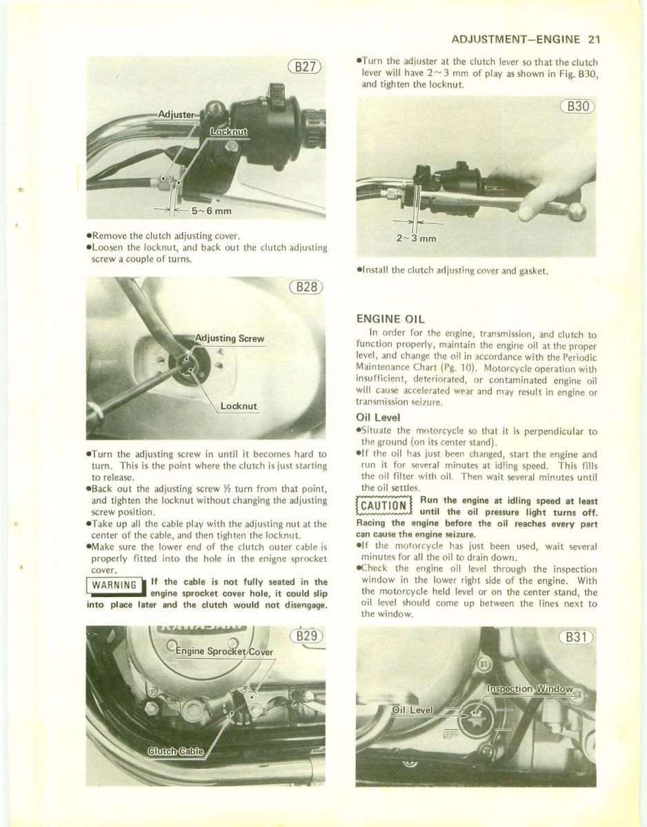

You need absolute a service manual
Get this and read and learn more about your bike and how to handle your problems the right way..
www.kzrider.com/modules/ServiceManuals/K...Service%20Manual.pdf

Theres one of the clutch lever... With no lock nut so not sure how to adjust clutch.

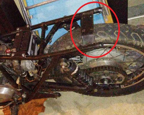

Bike pic.. The pods arnt on at the moment cause i was sprayin starter fluid prayin for somethin. And the the ghetto crankcase breather
Frame cut waitin for seat in the mail. And tank primed ready for paint

Frame cut. Congratulations - your bike now has independent rear suspension. Oh wait - that's good on a car / bad on a bike. You need to find someone who can weld because that little piece of original sheet metal connecting the frame rails isn't adequate to keep the rails aligned when you're riding. Ed

Your rear frame is very unstable and your rear shocks are too short!! When you hit the next road hole your tire hit the rear frame bracket!! This can cause a real bad road accident by a blocking wheel or ripped rear tire!!
Be careful with it.
