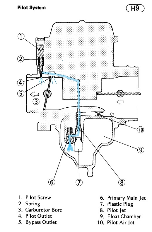

The choke is an enrichening circuit. A bike dying after disengaging the choke sometimes indicates plugged pilot circuits as they act as the idle circuits. Try cracking open the throttle a little, then close the choke. or set the idle higher.

Well I believe you were right about the pilot jet. I couldn't clean them the first time I went through the carburetors because I didn't have a thin enough flat-head. Bought one, went through a second time cleaning the pilot jets and even going through them with a tiny wire.
Patton:
I think I sprayed those...thanks for the diagram though! I just noticed those two holes and didn't know where they went, but decided to spray them anyway. Now I actually know where they lead.
After cleaning the pilot jets, I was able to start the bike even without the choke.
