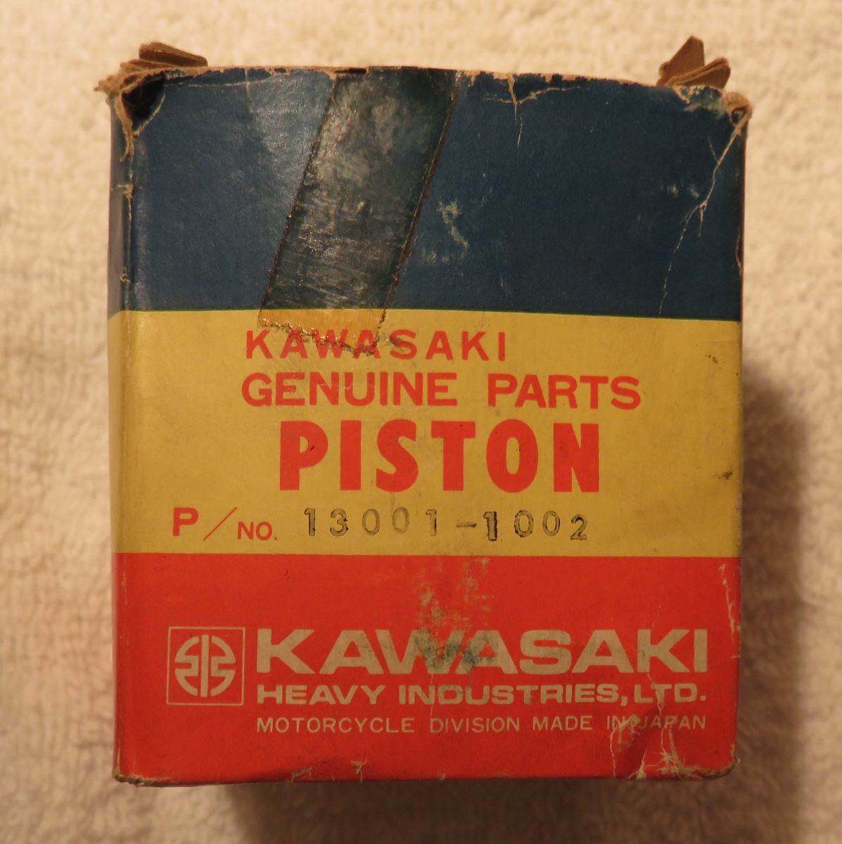

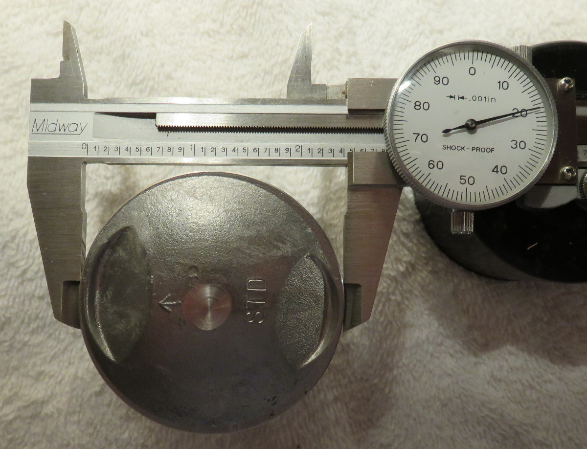

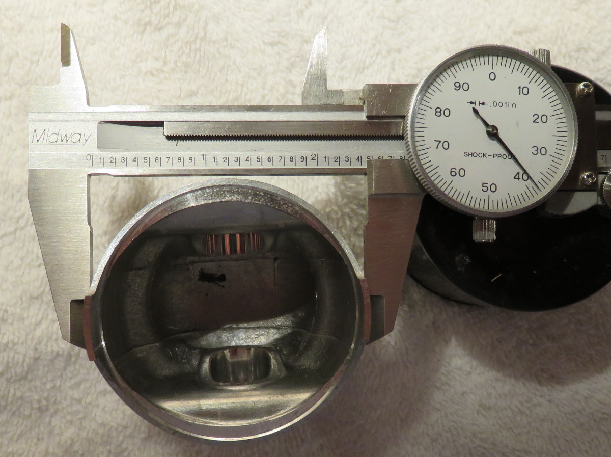

08 Aug 2017 19:16 - 08 Aug 2017 19:17Trumpology101 wrote: ...Ed ah, engine was not up to normal operating temperature as I was checking valve clearance prior to the compression test.
That could make a difference. When cold, the top of each piston is actually a little smaller in diameter than the bottom of each piston. The theory is that when the engine is at full operating temperature the piston tops are hotter than the piston bottoms and therefore expand a bit more than the bottoms. At that point that expansion should seat the piston rings properly in the cylinder bores. Below are a couple pics of stock KZ650 piston top and bottom measurements. Ed
