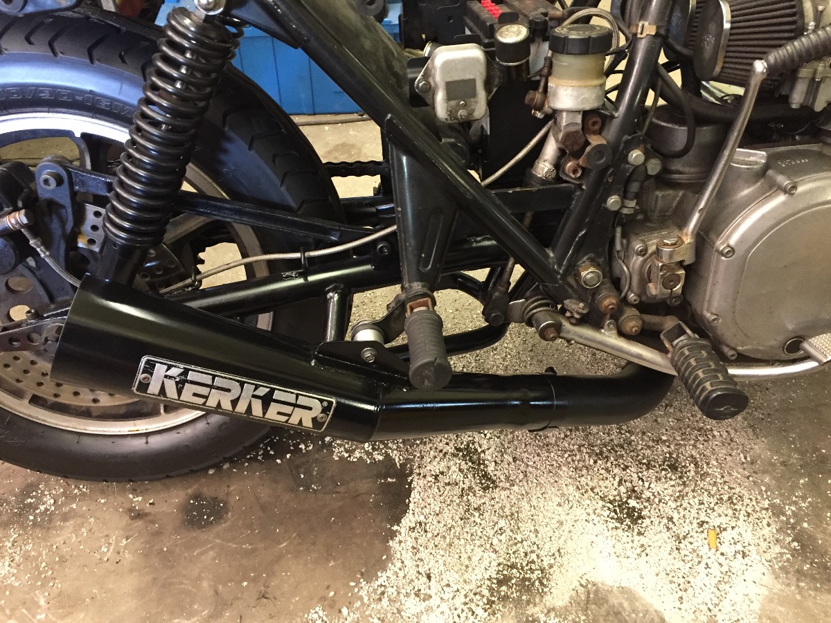

........ Tried posting a video from my phone.....for some reason it wont post???..so how about a pic instead??? header and megaphone now on. sounds sweet.
