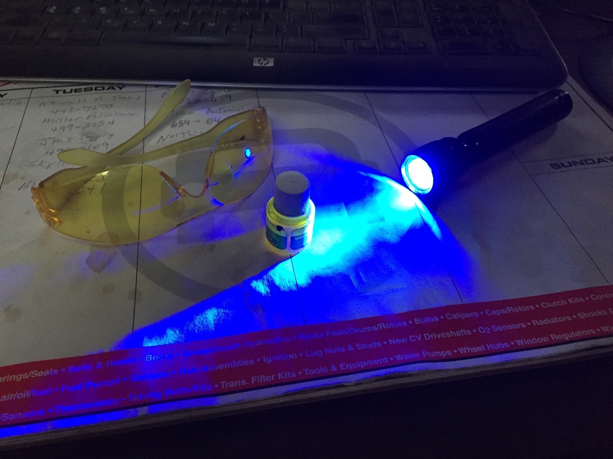

might need to go to the auto parts store and purchase an inexpensive kit with oil dye and a "black" light and some yellow glasses...it will show the leak..
