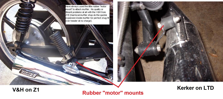

Could be wrong, but don't suspect the slightly more forward position of the Kerker muffler when fitted onto the Delkevic collector would meet with any interference against chassis parts.
Am uncertain where the Kerker muffler attachment tab is presently connected to the chassis (thinking likely the stock attachment position). With Kerker muffler in a further forward position, a hanger strap might need to be fashioned in order to connect the tab to the frame. Here's a pic of mine with a rubber mount that isolates vibration from the frame.
In event the Kerker fits too snugly onto the Delkevic collector, your local automotive muffler shop would likely be able to expand the Kerker I.D. to achieve a perfect fit. This worked very well with my V&H system --left the chrome plating completely intact -- and avoided the option of finish-destroying sanding and/or drum-sanding and/or honing to achieve an acceptable slide-on fit.

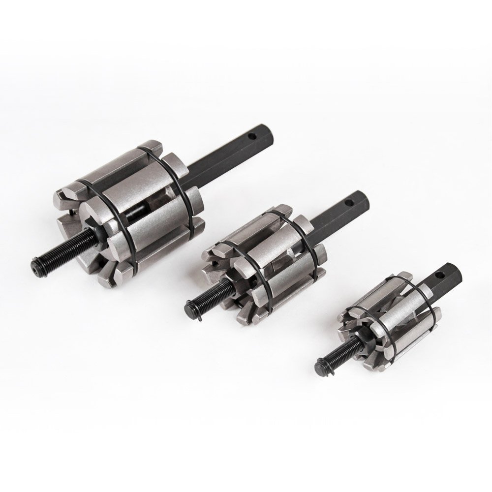

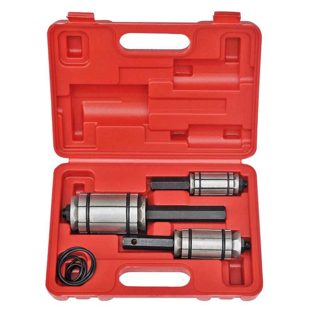

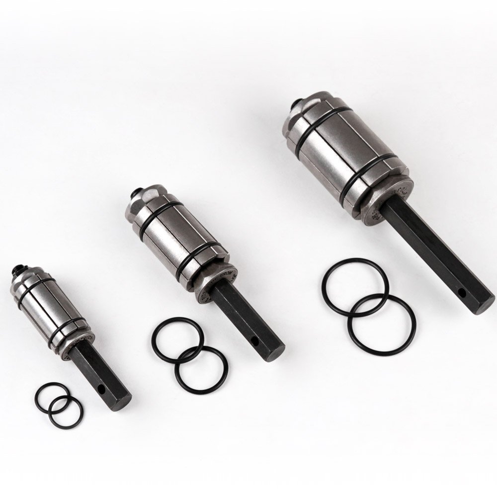

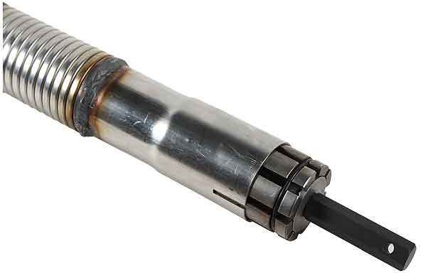

Re: Delkevic down pipes with Kerker muffler
23 Jun 2017 13:26
This would be the right tool to get the right ID or OD for a snug fit.
Set ΓΈ 30 - 85 mm
www.amazon.de/Jago-Rohraufweiter-Erweite...reizer/dp/B00BEDAWVO
Set ΓΈ 30 - 85 mm
