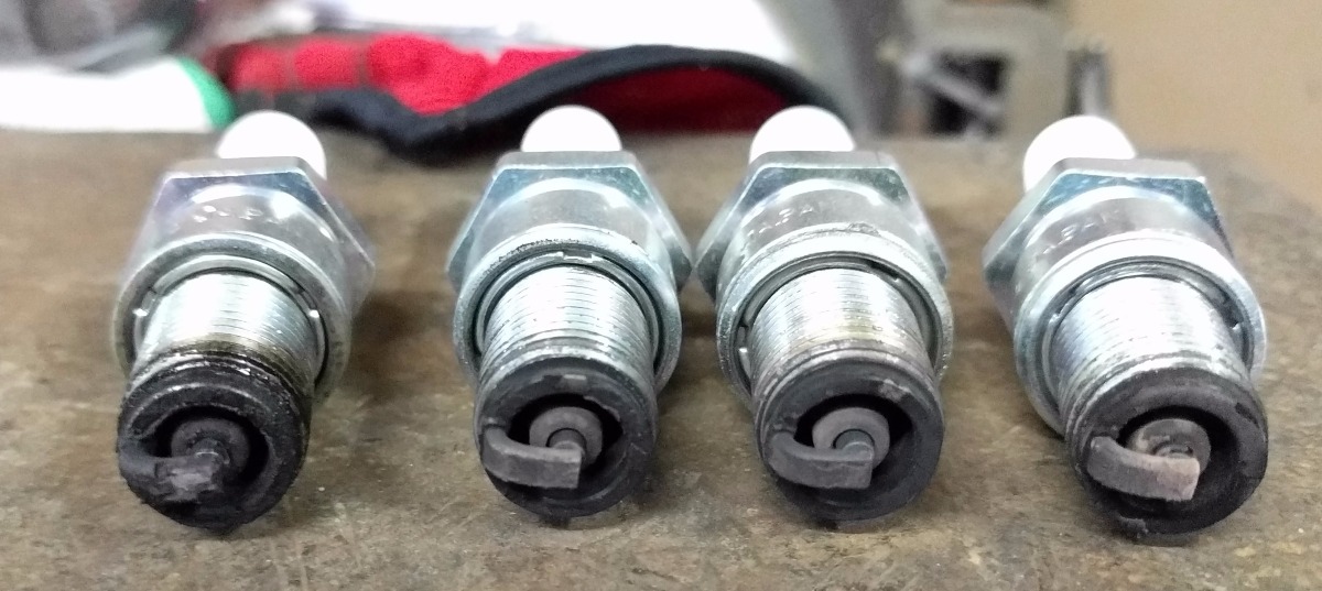

Finally got a compression tester. I tested on cold engine since a couple of sources said the difference is not critical. So from left to right I get 168, 170, 155, 170. I didn't drain the carbs since no other sources said I should and more importantly I don't know how to
Then I tested the 155 cylinder with oil and the pressure went right up. Spark plugs however are a different story with the first one being all black and oily and the other three look pretty much the same nice and dry I have pics if you need. Are these results telling me anything useful about my engine?
