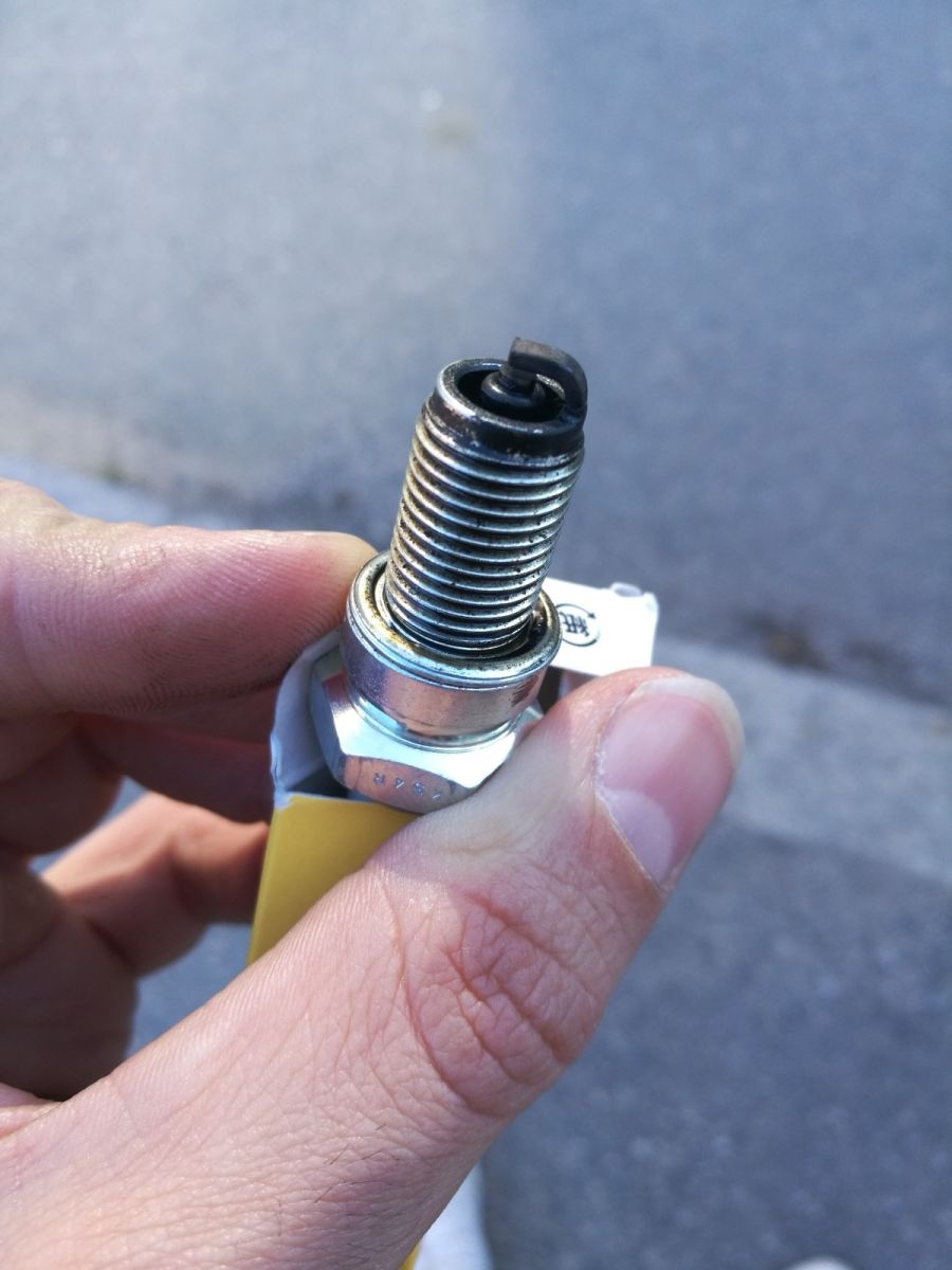

03 Jun 2017 09:24Here is the plug i removed. I installed that one like 1 month ago. I changed with nex plug and the bike runs fine. No blue smoke nothing but it back fires a bit only when it's standing. As soon as i rev the bike it's smooth...
Any thoughts?

As already suggested Valve Guide Seals.
Not just mileage , but age kills these rubber bits .
I had the same condition once and that fixed it
Re: running on 3 cylinders unless spark plug changed
03 Jun 2017 09:36 - 03 Jun 2017 09:36
My bet is on the seals.
Last edit: 03 Jun 2017 09:36 by SWest.

Thanks guys ! So these
www.suzukiperformancespares.co.uk/produc...lve-stem-seals/3553/
I also saw that this type of wear on the spark plug could be unproper ignition voltage to the plug. Since I changed the ignition coil for 1&3 but didn't do 2&4 that could be a fix too.
Will first change the coils and then see how it goes. I guess for the valve seal I need to take the engine apart...
M
