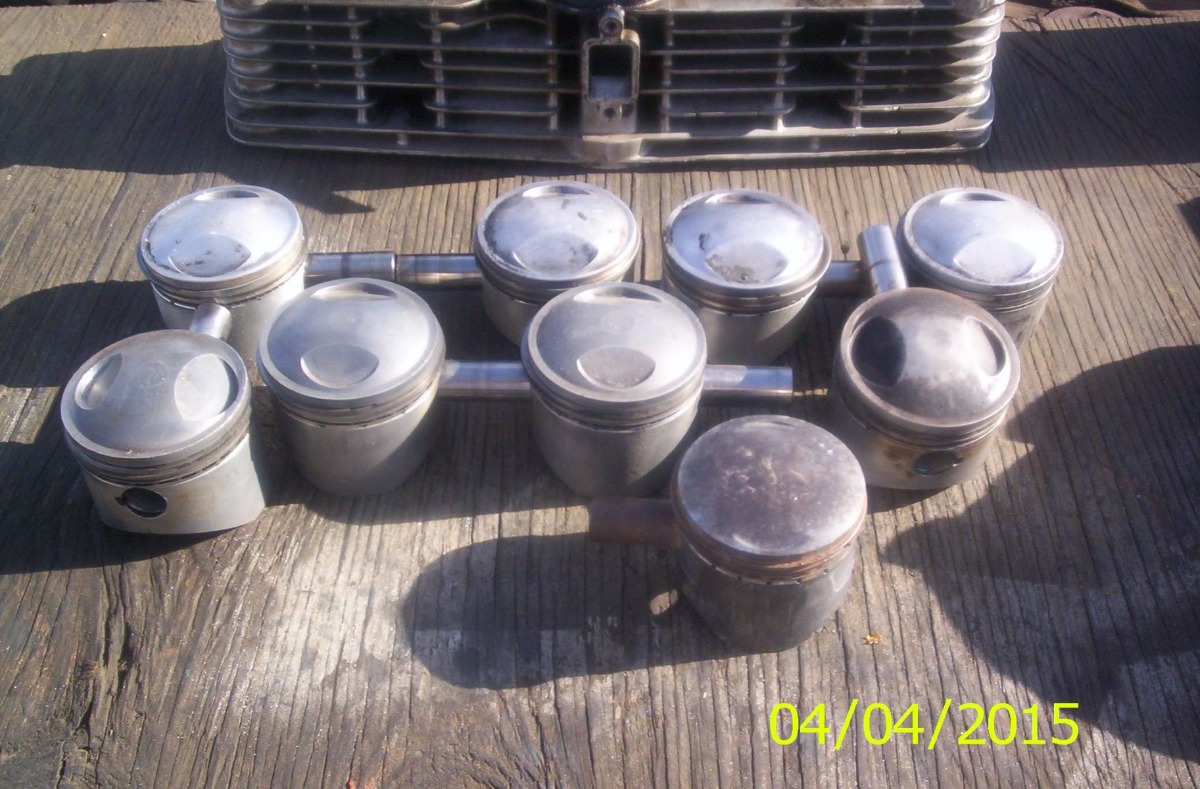

Re: Seller says bike has 1075 kit, But does it really?
21 May 2017 10:24
The following user(s) said Thank You: 1981kz750ltd

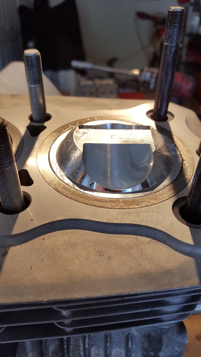

They do make a 72mm 1075 kit for J engines. Got the MTC kit in mine. Wiseco makes it also.
www.mtceng.com/mtcproducts/products/pistons/kawasaki/jmodel
And if you see a dome through the plug hole it has a kit installed. I don't know of any aftermarket pistons for a standard bore.
If the piston top looks like this it's MTC. A lesser dome is most likely Wiseco.
