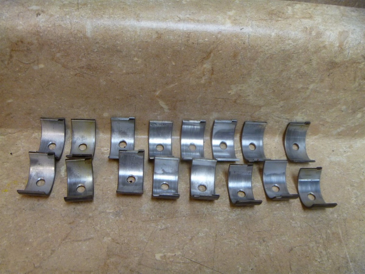

    In my case there was a oil pressure problem caused by the welding. I corrected it but too late. The valve train doesn't sing like they did and oil pressure is down a little. The bearings are almost $10 a piece now. The cams are still in spec and I just ordered a whole set of bearings for $30 shipped. Came out of a KZ 1100 with 22,000 miles on it.
www.z1enterprises.com/cam-bearing-z1-kz900-1000-2.html
I changed mine in 13 and god only knows how many miles were on them. The ones shown in the clip are them. I should be able to make up a good set with the new ones. I'll consider myself lucky if this is all it is.

    Well I got them. Coulda mixed and matched what I had. I'll feel better having a matched set.

    Do you mean each shell half is $10.00 each! Wow. If yes, that adds up fast.

    Yup, that's why I slapped up these used ones.

07 Jun 2017 19:39
    Got em in.

    Much tighter. What I have will work. Didn't have to plastigage them. All clearances were tighter. Had to adjust six valves. More to come.
