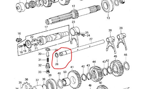

I had a problem a long time ago where it would pop out of gear and it was the groove for the lock washer(26) on my shift rod(27) was cut too shallow and the lock washer came off and the rod slipped out, thankfully not damaging anything.
Don't ride with it like that!
