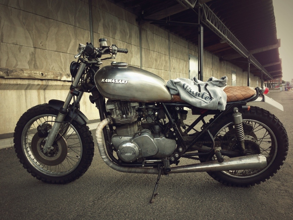

Hi! I have the plug fouling issue on my Kawasaki KZ750 Twin 1976 (KZ750B, Z750B). The bike runs great and starts easy with the kickstart with new plugs but they get fouled quite quick. Maybe like 100km or something near that. More on the right cylinder than the left. Have ridden the bike for like 7000KM in maybe 5 years with a lot of plug changes:)
Have tried almost everything except oil seals and piston rings now. Really like the bike and I think it will be with me for the rest of my life.
- Dyna S ignition spot on installed.
- Dynatek coil
- Strong spark with new plugs.
- Valve clearance within specs.
- Former perfectly clean BS38.
- Now new VM34s with Jetting: 200 mains, 27.5 pilots, 159 P-8 needle jets, 6FJ6 jet needles, 2.0 slides, and 2.0 air jets..
- Pod filters.
- Shorty mufflers
- Have tried every spark plug from B6ES-B9ES and the Iridium BR7EIX (I think that was the name) with the same result.
Have not done compression- or leak test yet.
Is it hard to change the oil seals and piston rings? I have the shop manual and read it for a couple of years now:) Do you need the special tools or can you do it otherwise?

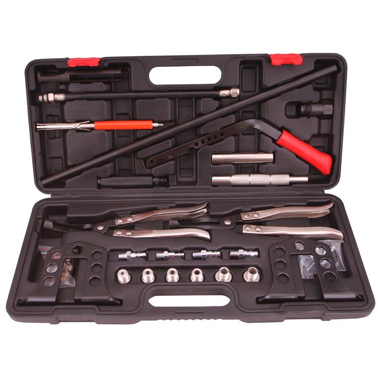

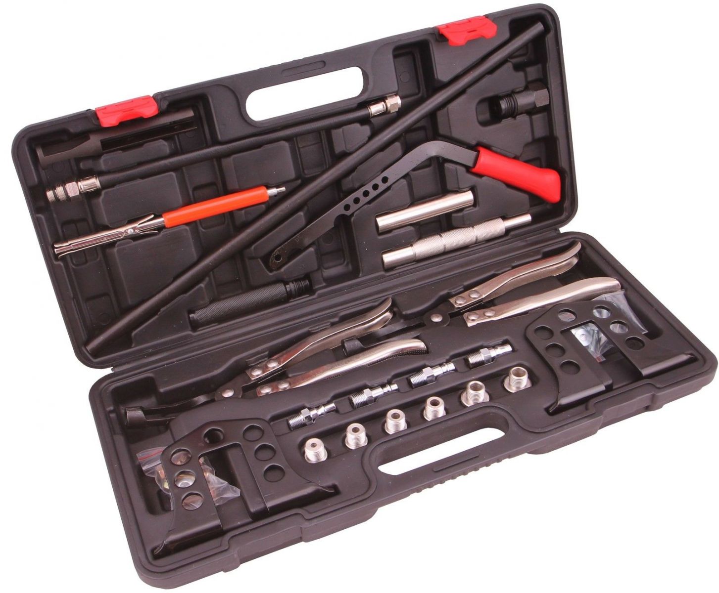

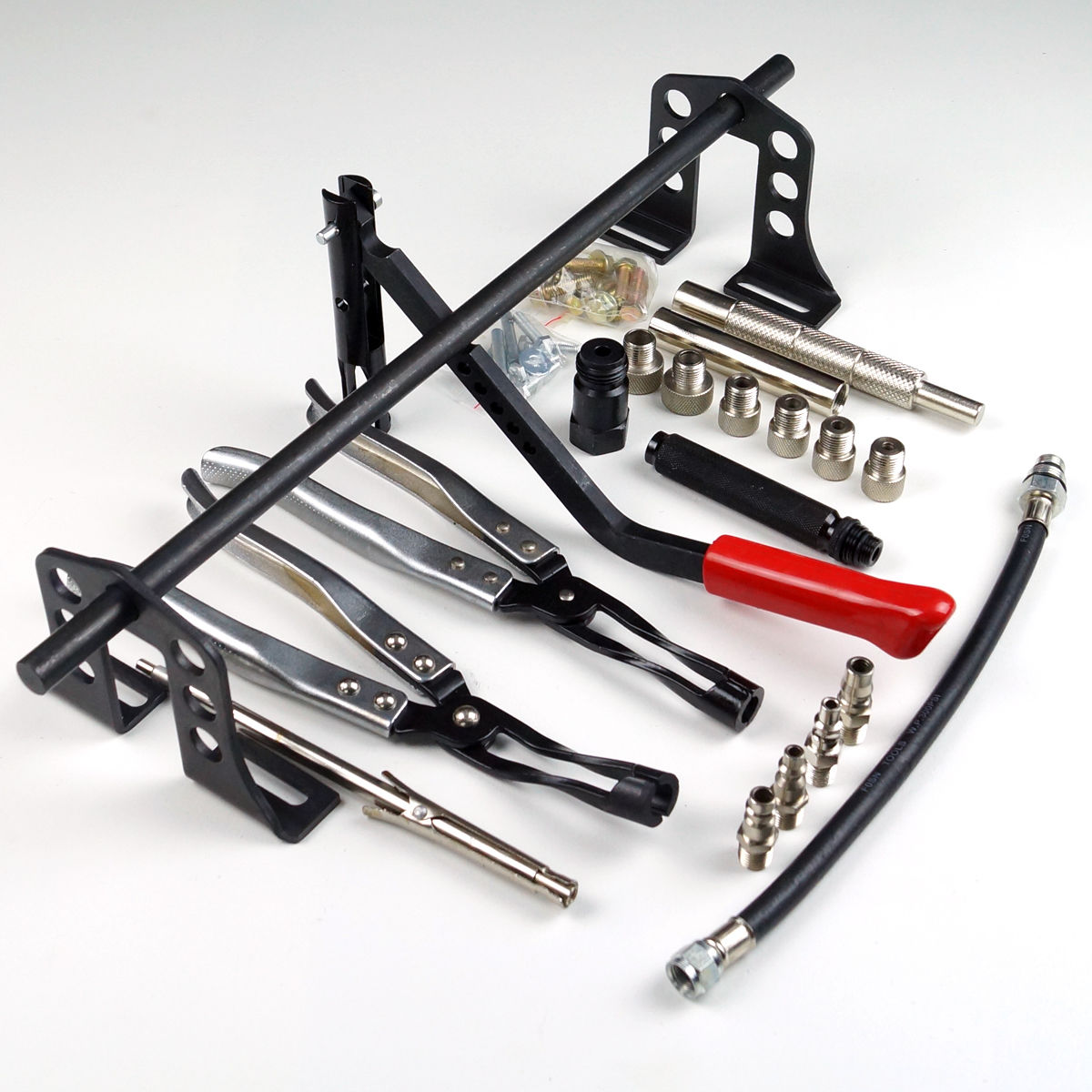

No eBay APP ID and/or Cert ID defined in Kunena configurationHello Shellsson
eBay is a good source for the right tools
This tool set include all you need, seal puller grip and remounting tabs for the seals

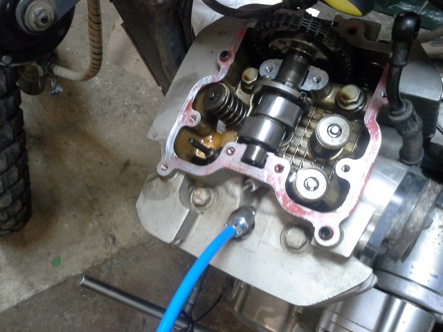

No need to remove the cylinder head for the valve seal job. In this tool set is a spark plug adapter to put compress air into
combustion chamber on TDC to prevent that the vale fall down into the cylinder or hit the piston.
Michael
