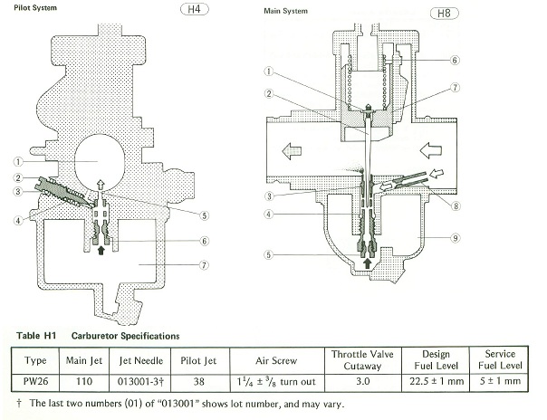

rapfl wrote: Hi guys, I'm having a similar problem with my Z200. Could you describe how you adjusted the fuel screw? Did you just try different settings?
My wild guess at this point for the carb at hand is that the pilot screw is a pilot air screw as opposed to a pilot fuel mixture screw.
Could try turning the pilot air screw 1/2 turn clockwise to enrichen the pilot circuit, and do a test ride.
If the condition worsens, try turning the pilot air screw counter-clockwise 1/2 turn back to where it was, and then turn it an additional 1/2 turn counter-clockwise, and do a test ride.
Am uncertain as to whether or not the following diagram is of the carb at hand.
