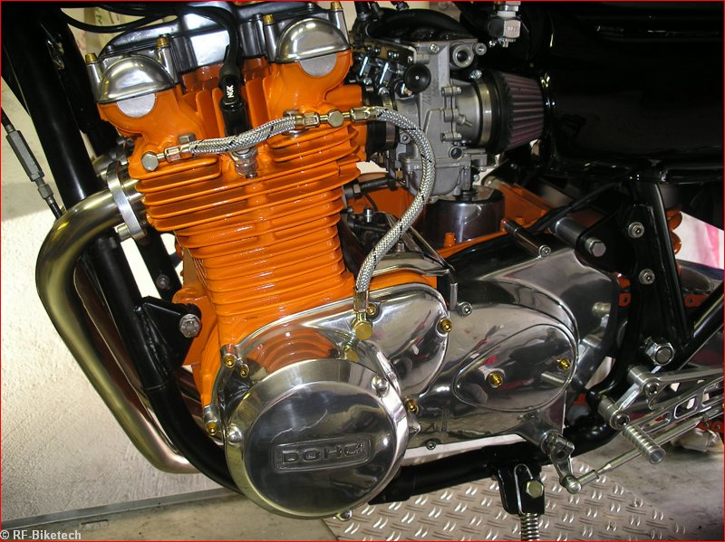

The oil galley plug behind the head bolt is a press fit aluminum plug.
Before i would remove the head i would try to do a little light hit with a drift punch to stop the leaking.
If you pull the plug(s) you can do a oil line mod like this
