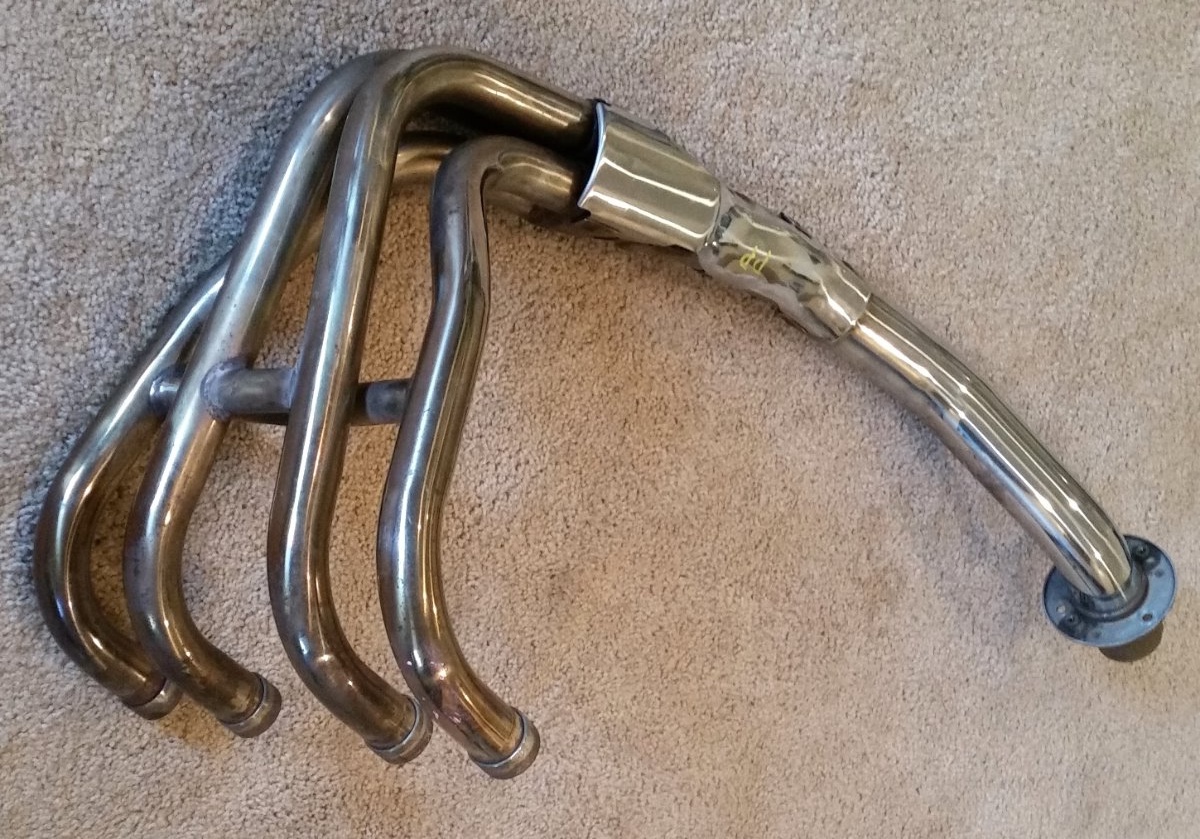

I'm finally getting some motivation to get my GPz rebuilt. I will be using a ZR7S header again when I do so. (A ZR7 head as well as a matter of fact. I buggered up my head after I bought it and the only easy to find, affordable replacement option is the ZR7 which is fine with me.)
Anyway, the collector and mid-pipe get in the way of the oil plug and filter so I would like to do a quick release mod but I'm not exactly sure of the proper way to go about it. OK, weld on attach point for springs, I got that but what do you use for the header washers? Use standard washers, Fiber, something else? What options there for anchoring it to the head. I've seen everything from Hooking the srings to standard collars to loops welded on the collar bolts what works best?

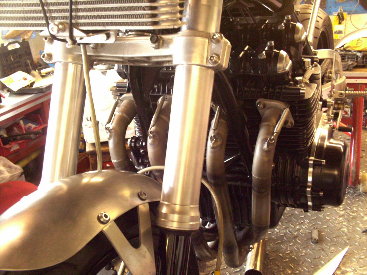

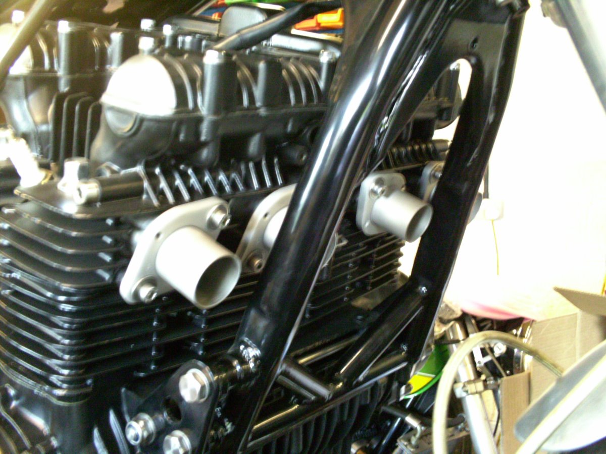

At the head you need to create stubs that bolt to the head as normal but then have the down pipes a slip on fit to these using springs to retain.
The flanges use stock exhaust gaskets and stay on the head whilst the header pipes are a snug slip fit and use no sealer or gaskets.
You simply need to squarely cut the headers around 1.5 inch from the flanges and use four short sections of larger diameter tube to weld to the down pipes to create the slip on function.
After that you just need to weld on some tags for the springs.
Just trying to spring fit the entire exhaust to the head wont work.

All slip ons for most Jap road bikes use flanges bolted to the head with stubs that either slip in or over the pipes.
The pipes that slip directly into the head castings are early stuff like triumphs, bsa's , Enfields etc etc or race 2 strokes, TZ's / Motocross bikes which slip over a cast stub that is part of the barrel and have heat resistant 'O' rings in the header to form a seal.

I just used what exhaust bits I had lying around but they are from salvaged stock stainless systems from a zx9r and R6.
The springs are stainless exhaust springs off Ebay.

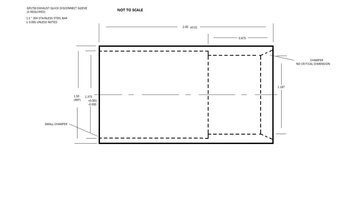

14 Apr 2017 08:30
Thanks, I know your bikes are track and drag bikes so I might put a dab of copper grease on to be safe since this will be as close to a daily driver as possible. I took some measurements off the header I just got off ebay and worked out a design for the sleeves. These wont protrude past the collars like yours do.
