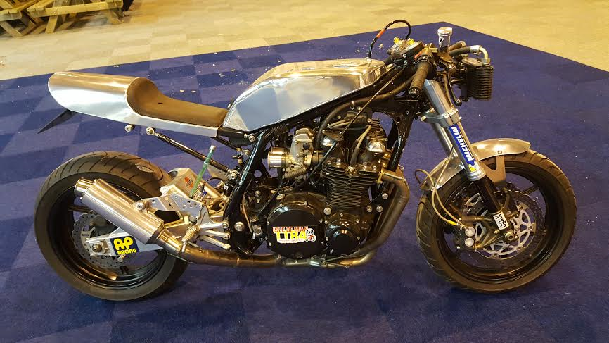

Zed 's fine ride was a Bike of the Month
Here is a picture showing more than a closeup
Dave B) B) B)

Yep! One mean machine.
