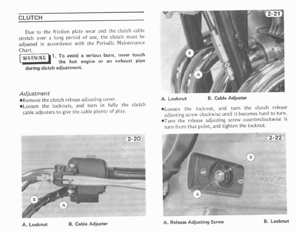

I'm assuming you tried a clutch release adjustment. In what direction are you turning the clutch release adjusting screw?
On the KZ1000-P, it may be that you're supposed to turn it counterclockwise first until hard to turn, then clockwise 1/4 to 1/2 turn. see the owner's manual or factory service manual for the procedure. some manuals are ambiguous as to the direction to turn it. On some models it's clockwise first. my 81 650 is counterclockwise first.

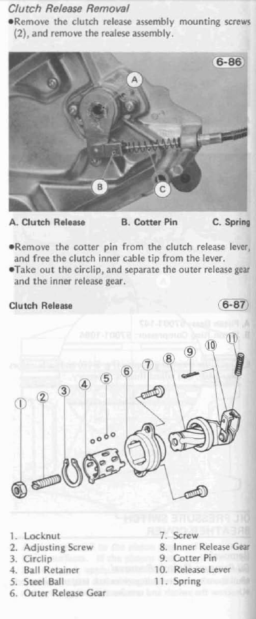

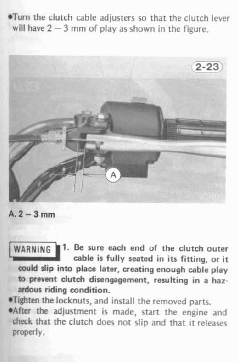

Here are the manual pages for the clutch adjustment.
Here is the manual page for the clutch release which is under the sprocket cover.
Your clutch release mechanism may be different than shown, I have an '88 and it is different. I would still recommend pulling apart what you have, cleaning, greasing and reassembling.
Now go buy an Kawasaki manual. If you are going to keep that bike running you will need it.
