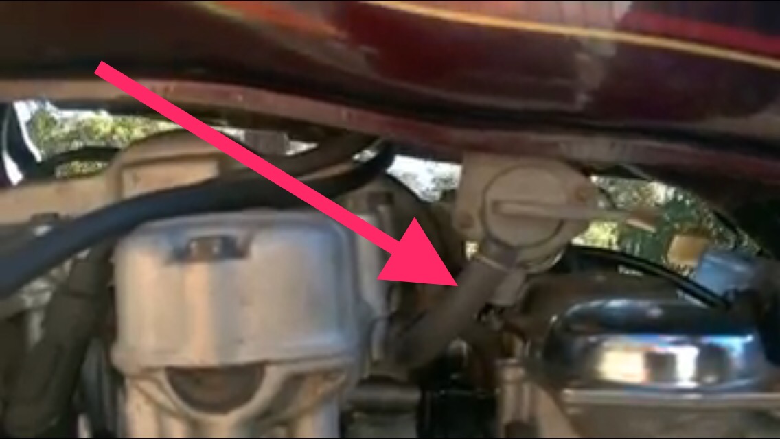

As other members have pointed out, that noise you hear is your primary chain and backlash in your clutch and transmission.
The reason why it is so bad, is that is appears you are running on three cylinders because you have the vacuum line to your fuel petcock unplugged. The carb that vacuum line is plugged into is sucking to much air and is either not allowing proper combustion or is melting your piston and valves.
Address that issue first and foremost.

i saw in your video that the vacuum hose at the fuel tap spit back.
This caused a rough idle!
Have you try to block the vacuum hose temporary with a screw?
Daftrusty was faster.

10 Mar 2017 15:30Daftrusty wrote: As other members have pointed out, that noise you hear is your primary chain and backlash in your clutch and transmission.
Good spotting. Yes, it the video I did have the vacuum line disconnected which amplified the problem. I had just finished adjusting the choke and needed the tank back on to get it running to test, and didn't hook everything back yet, and took the video at the same time. So yes, it doesn't usually sound this bad, but it's not far off. Besides, I wouldn't get very far without the vacuum line connected anyway
I agree with you all that carb syncing looks like the way to go. I've never done anything with a primary chain before, but going by the manual it looks like there isn't much that can be done except for making sure the carbs are synced and the drive chain is in good order and at the correct tension (which it is).
