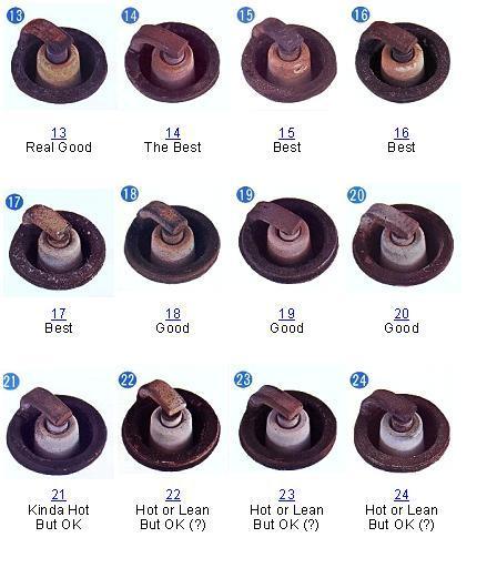

Hello Conspiracy
In my opinion motor runs to lean
Check fuel line, filter, jets, float high (clear tube test ) and vent in tank cap ( clogged = vacuum = insufficient fuel flow).
