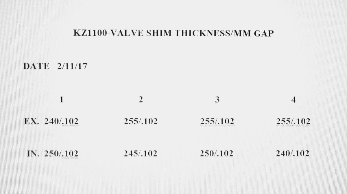

25 Feb 2017 07:50 - 25 Feb 2017 08:2576KZ900 wrote: Got adjustment done. Had enough factory shims from previous bikes to get them. Two of my intakes were real tight.. One I could barely turn with my fingers so it was way too tight. Also heli coiled one valve cover bolt. Now as soon as valve cover gets back from chrome shop I'll be in business.
What did you end up with for gap measurements?

I found it when I adjusted the valves.

.102 for all but two that were .076
