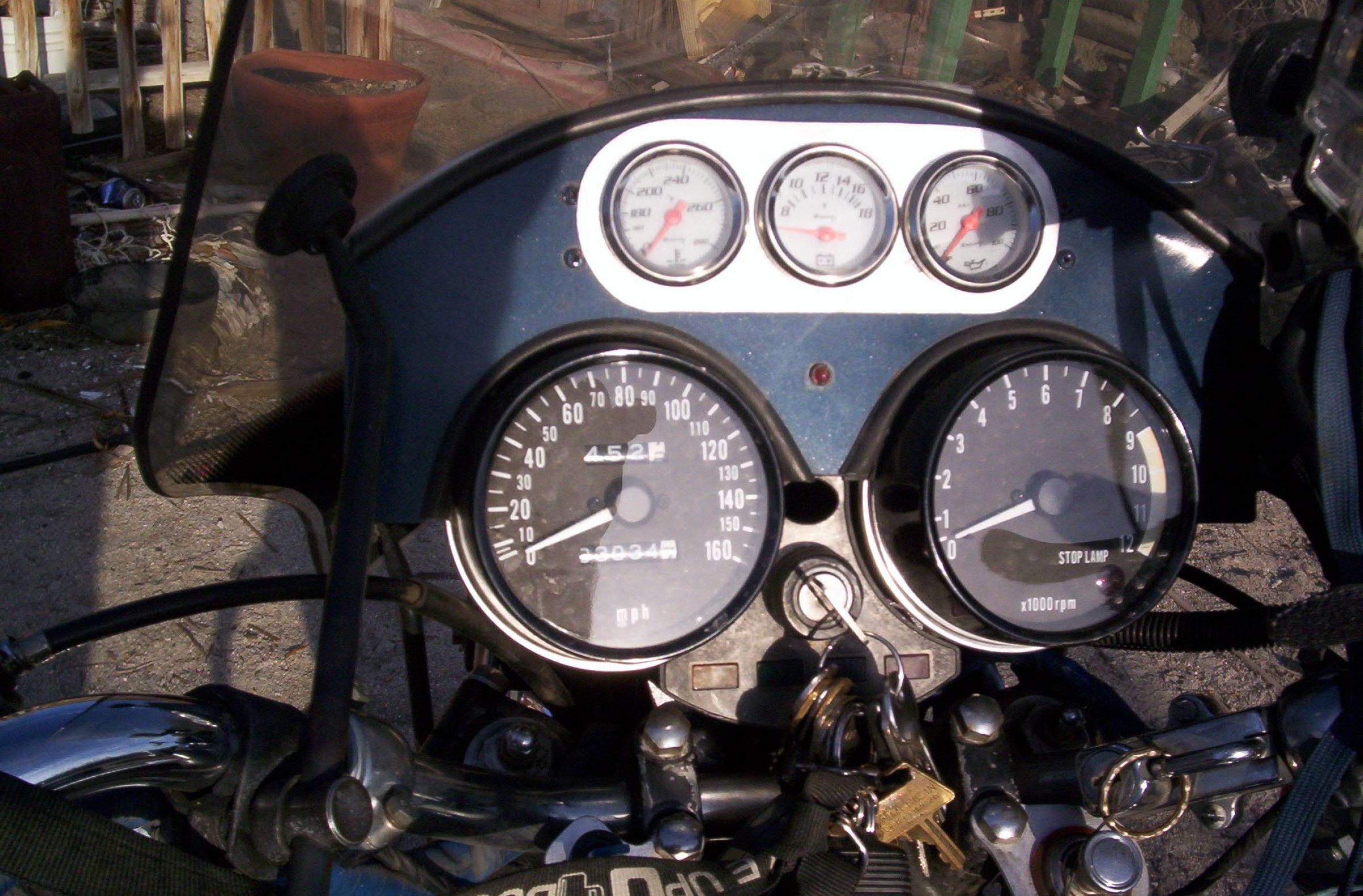

I'm using a 60 PSI gauge. This morning while warming up my dash gauge and the one below read 40 PSI. It drops down to 20 then runs at 10 when hot.
