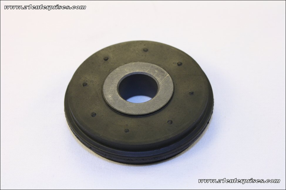

2 strokes are a different kettle of fish. Unless it's a race motor the big fours will go for a long, long time without major work. Normally the only leak will be the O ring around the cam chain tunnel. Usually it's because the material has hardened and cracked. By that time the "rubberized" rollers will be doing the same thing and need to be replaced. The Liska rollers will hold up indefinitely at 1/2 the price but that still leaves the center idler below the barrels and the guide in the front where the head meets the barrels. I've thought about a copper gasket but the gasket is so cheap and the seal so good, I wouldn't go with copper there. I did go with a one piece head gasket due to the O ring issue. Enen a new one started leaking the first year in 13. NOS rubber is bunk and I have no confidence in the aftermarket ones. Mine is fiber but next time I will install a one piece copper head gasket. Maybe. :whistle:
