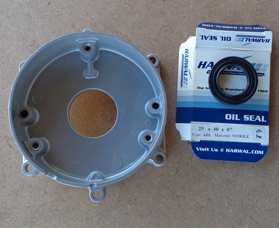

You should remove ignition housing. It would be tedious, but they make seal pullers with 3 jaws that could hook the seal and pull out.
Pretty simple, You can get a seal at any industrial supply place. 25mm x 40mm x 7mm. I just sold this housing with a new seal on ebay for $25.
