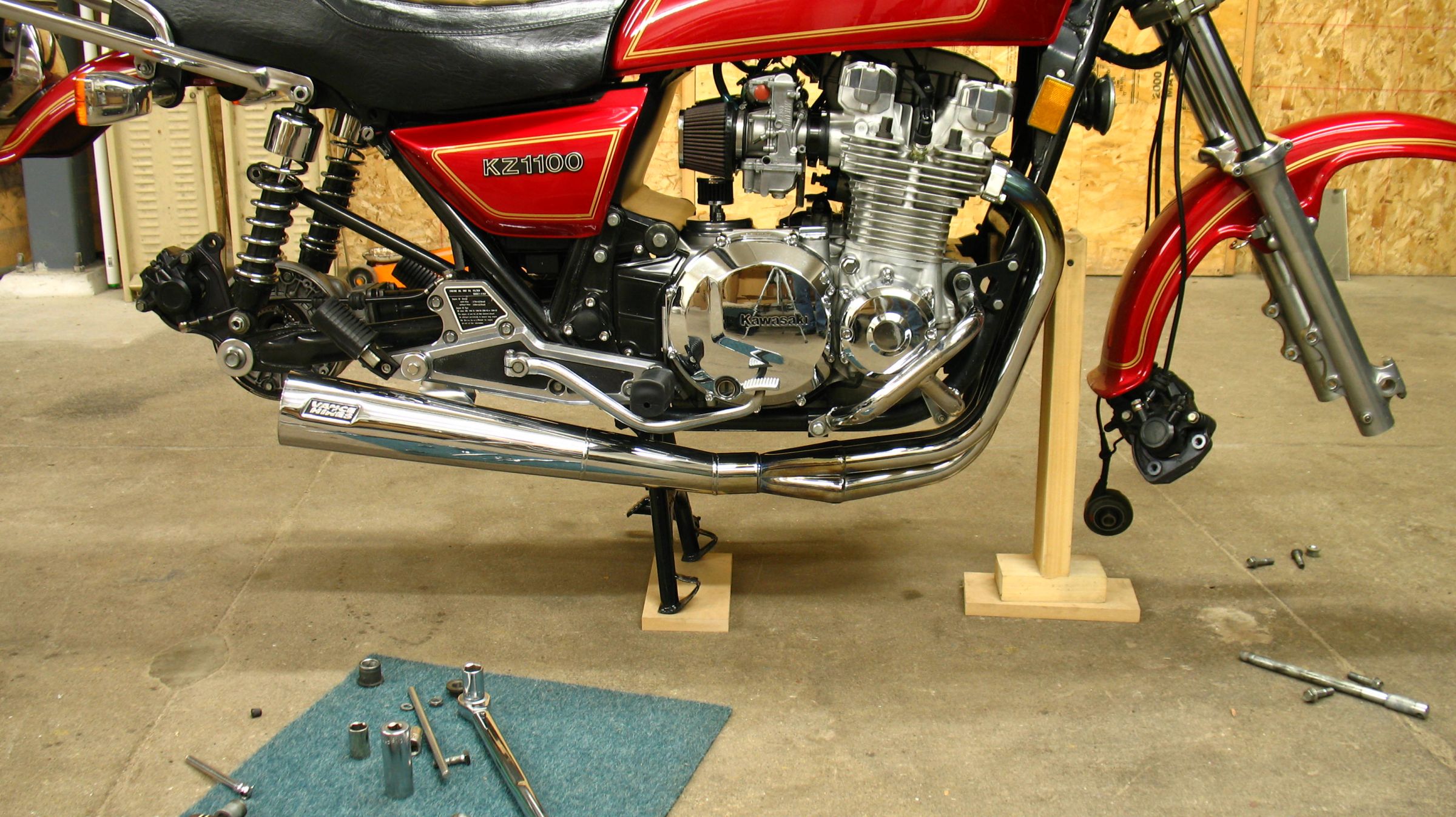

See:
www.kzrider.com/forum/23-for-sale/603532...to-1-chrome-1000-900
I have the same set (13009-J) on my 82 1100A It required a tweak or two to fit, but has been well worth the effort.
The header pipe section fits to the head properly, but the first inside bend of pipe #3 made slight contact with the cross member of the frame directly in front of the cylinder block. Worked around that, and flattened the megaphone bracket in a vise to fit the angle of the foot peg bracket, which is longer than the one on a 1000J.
No issue changing oil filters, and the chrome finish holds up well. It works with the center-stand, if you want to keep it on the bike.

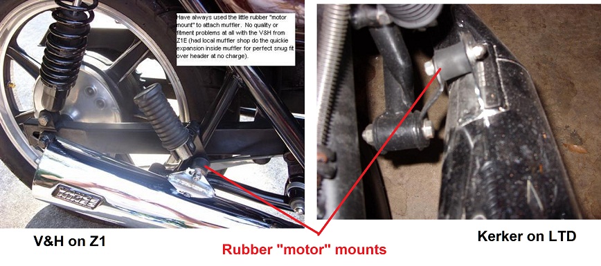

When needing to fabricate a simple hanger bracket, it's remarkable how much vibration is eliminated for the rider by including a small rubber damper which isolates the muffler vibration away from the frame.
