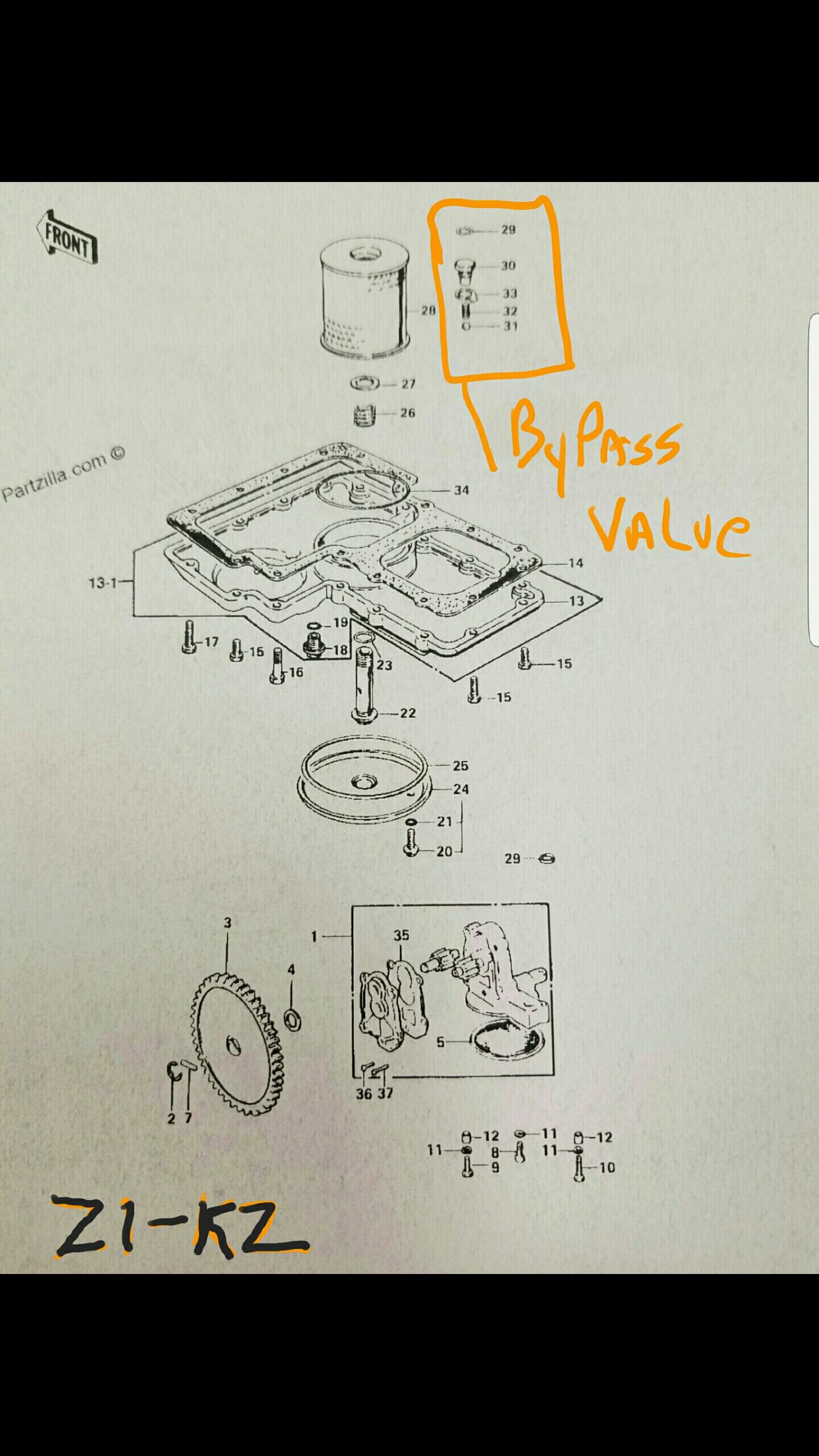

Ok I'll start by saying I'm convinced that I need a larger oil cooler and most likley fittings.
Several people tried to tell me that. (Hi Steve and Lou!)
I also read conflicting info saying my setup would be fine, and that was backed up with the fact that I have a stock Gpz1100 factory oil cooler in my garage to inspect. The factory cooler has a smaller line ID throughout than what I'm using, in fact the smallest opening is around 1/8".
Now I want to know why.
The Z1/KZ pumps are very simple. There's a pressure releif valve in the top of the filter cavity that lets oil back into the pan when pressure gets too high.
On the GPz oil pump that pressure relief valve was moved to the pump and also allows oil back into the pan at a specific pressure, my guess is that its set to open at a higher pressure to deal with pushing oil up and thru the cooler using smaller lines.
Am I making any sense?
Can someone confirm or deny?
The second difference I see is in the filter and the filter bolt itself.
The Z1/KZ part is just a hollow tube with holes for the filter oil to pass thru.
The GPz has a check valve built in that I'm guessing is used to keep the oil cooler oil from draining back out, preventing dry startups.
Confirm deny?
The third difference I'm not sure about, the GPz uses a shorter oil filter with some sort of plate above it.
No Idea why. Higher flow open element? Cheaper or better availability?
Here's what I'm looking at.

The Z1/KZ oil pump doesn't have a pressure relief valve. That is a bypass valve in case the filter gets clogged. The lines and fittings should not be less than 13mm ID. As for the later pump, I have no experiance with them. It could be they are a higher pressure pump and that is a release valve. I'd like to know more about that system.

The valve on the kz dumps oil back into the pan' just like the gpz.
I've got my pan off and can see it.

11 Sep 2016 14:43MadShad wrote: The valve on the kz dumps oil back into the pan' just like the gpz.
Just kidding.
I see now that it rerouts back into the oil supply.
That throws my theory out the window and is the info I needed.
Thanks!
