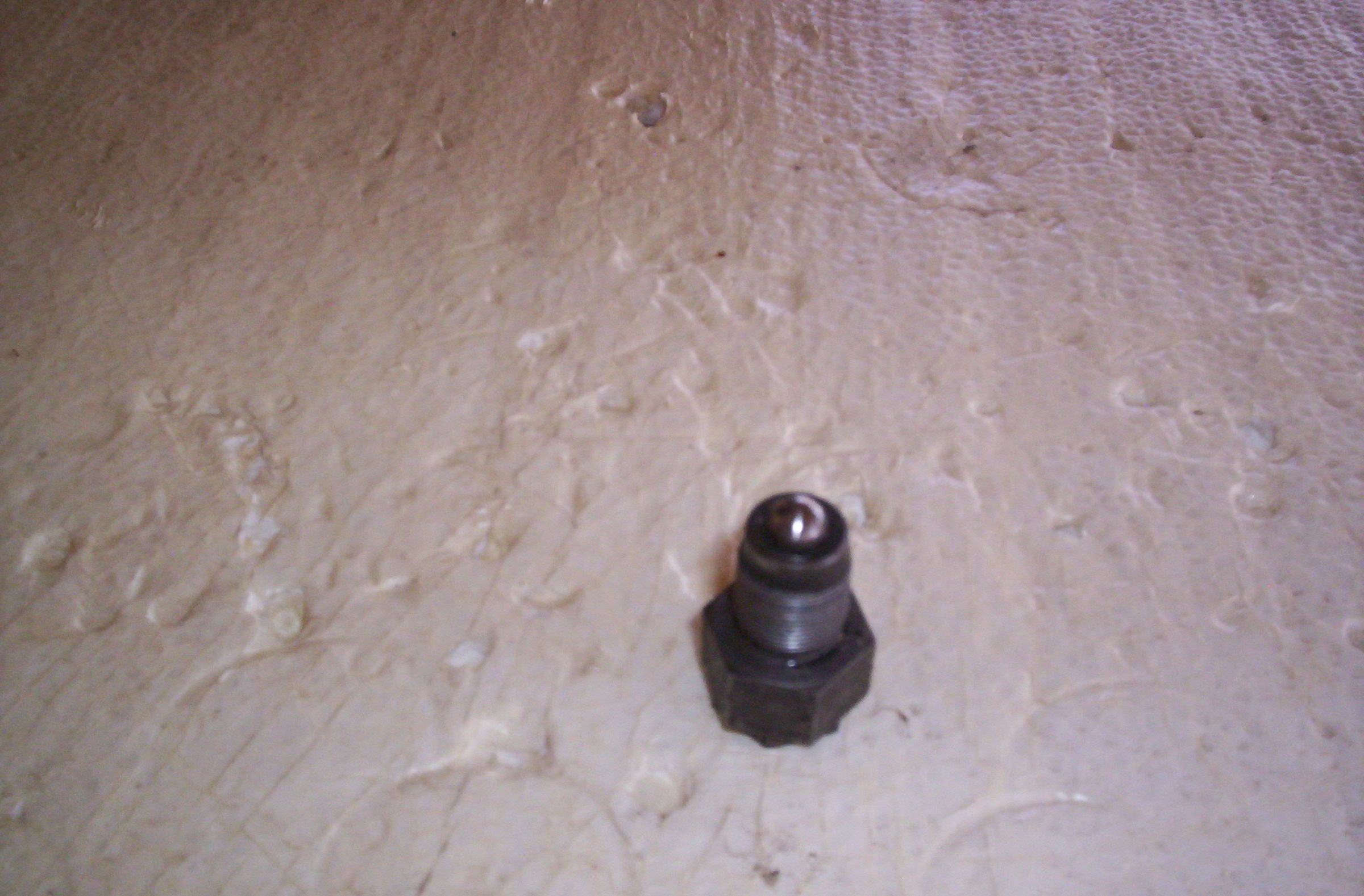

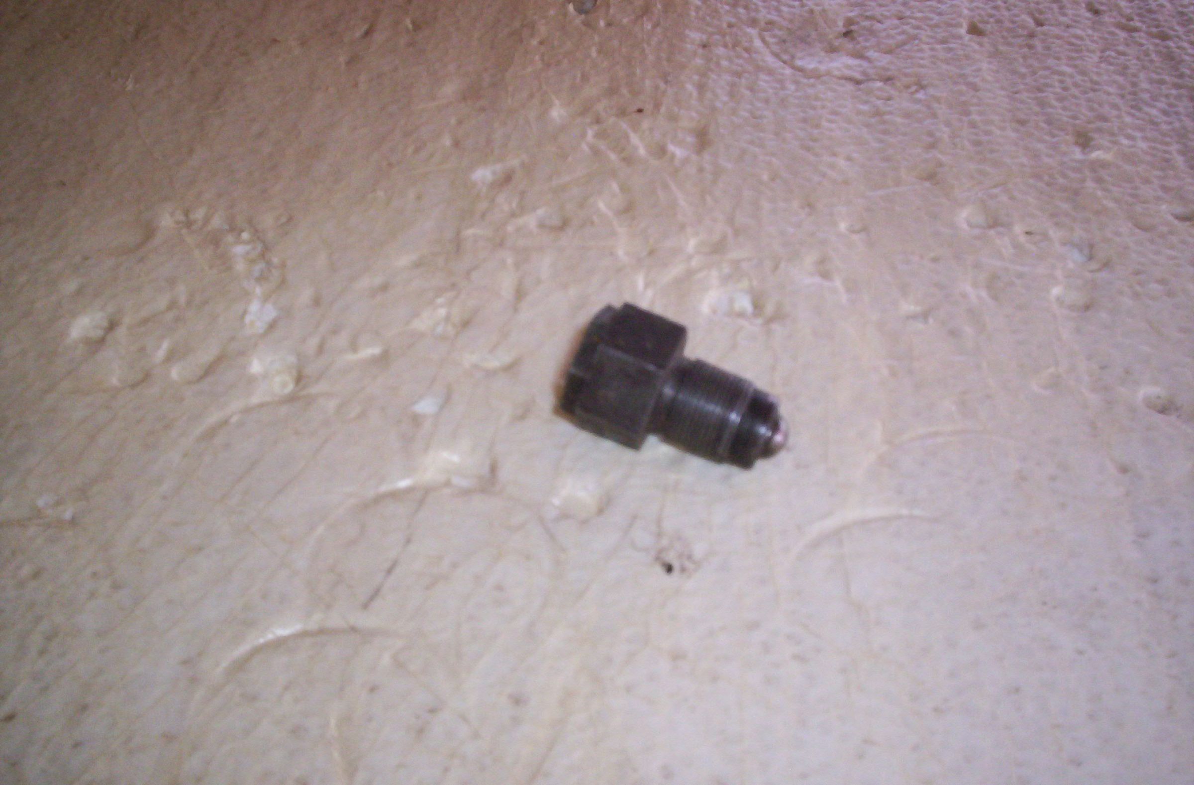

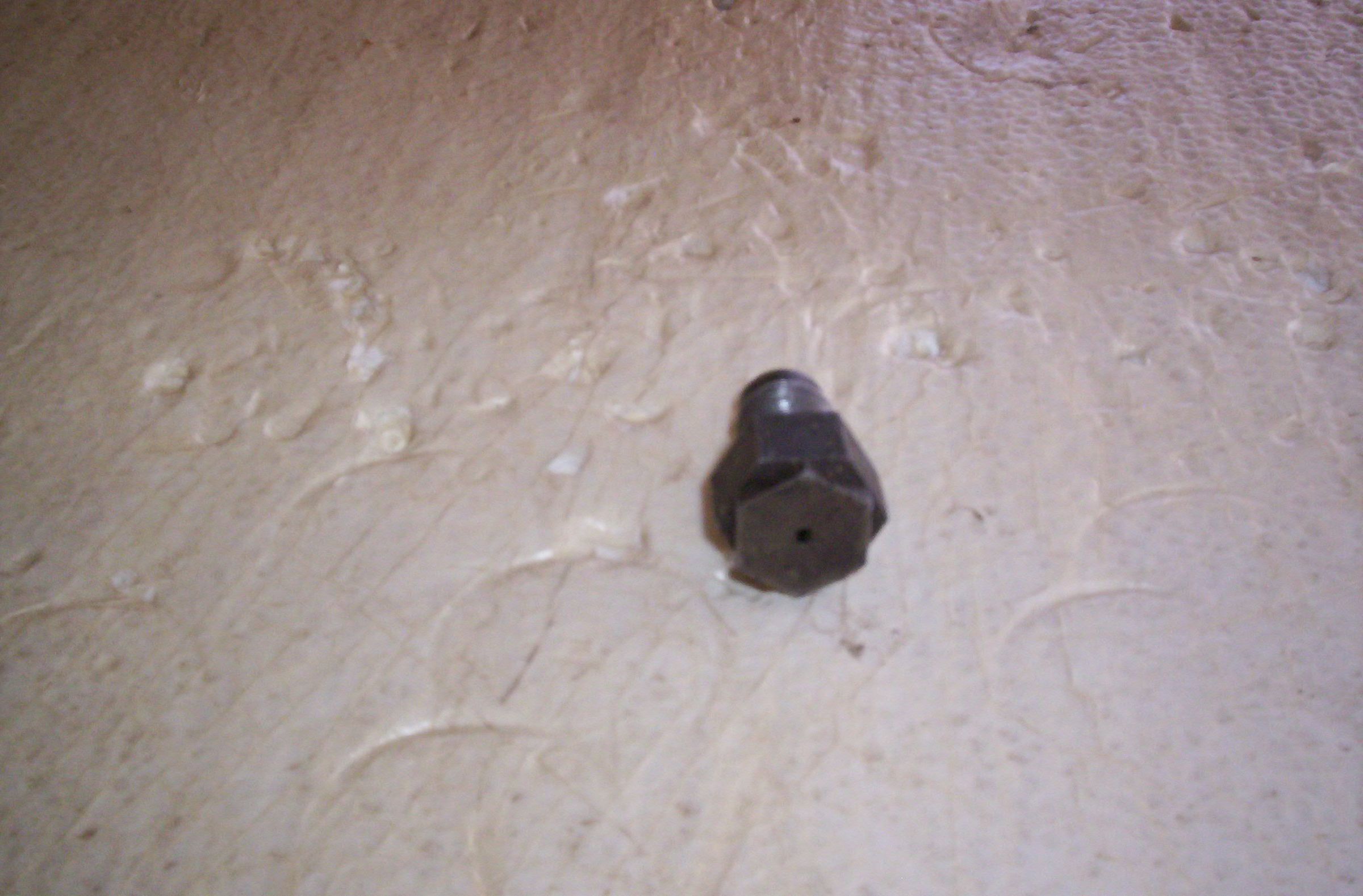

There's a bolt on my top case called a "shift drum positioning bolt" is that it? (fig. 20 in that diagram)
Can I remove this and take a look at the spring inside? Or will i be opening up a can of worms
1978 KZ400
Last edit: 09 Sep 2016 16:56 by de Courcy. Reason: added something
Re: KZ400 Shift Drum not turning
09 Sep 2016 17:32
There should be a thin washer you bend over to keep it from turning. Bend it down and remove the bolt. It should have the spring and in your case a pin. If they look OK and you still can't turn the drum, it's something else.

Thanks, where do I find this washer?
1978 KZ400
09 Sep 2016 18:24
I didn't see one in your pic. If it's there you'll see it.
