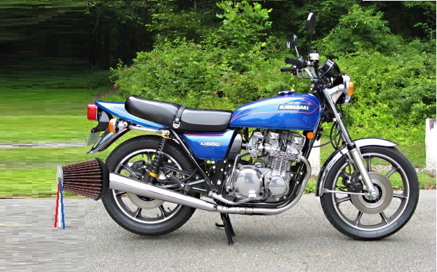

If extending with a hose I would run the end of the hose to the chain
Some run the hose into a catch can ( Beer can ) so not to drop any oil onto the road or drag strip.
Having no breather would be disastrous as the crankcase pressure needs to vent
Best to run hose past the leading face of the rear tire to prevent a loss in traction

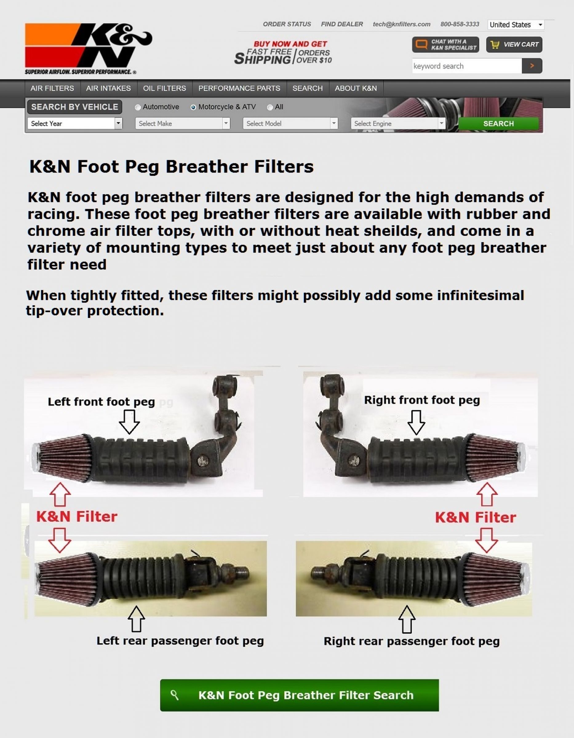

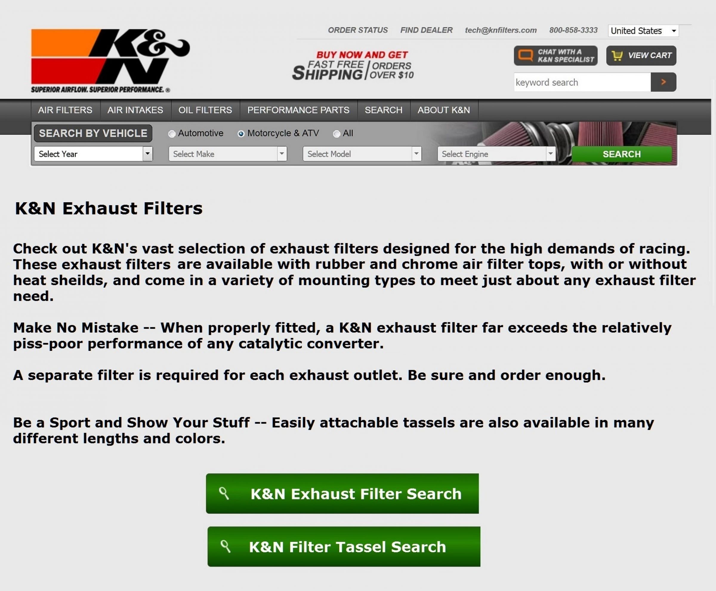

Patton wrote: K&N says the crankcase vent filters are designed for the high demands of racing. [Snicker-snicker-wink-wink]. Without further ado 'bout those high demands. And neglect to mention any professionals using them. But do take the time to also plug sale of K&N's filter cleaner and special red oil essential toward maintaining the filters.

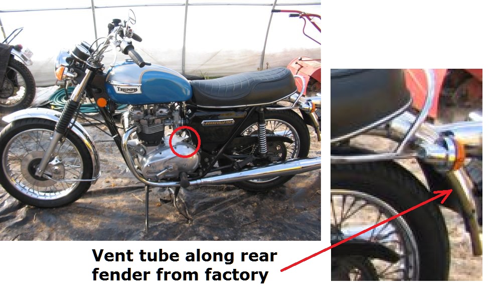

Hey, don't bring old Meriden Triumphs into this filter "engineering" topic :laugh: - hell, they didn't even put oil filters on their bikes back then.... :ohmy: :silly: (Don't get me wrong - I would pay big bucks for a nice stock 650 / 750 Bonneville).
I think K&N would use that statement on everything they sell - all hype and glitter. In the end, I believe the description was meant to refer to the free breathing ability of their crank case filter, in that it would not restrict crank case ventilation and cause seal failures or excessive oil consumption. even under racing conditions. And nothing is as demanding on a machine as racing....

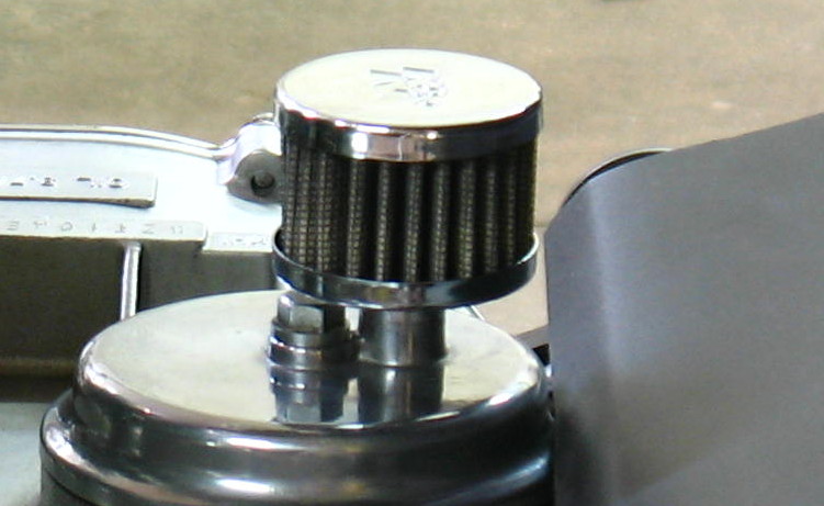

For now, I strenuously prefer the little filter for the utter-simplicity of it, if/for no other reason. There is no oily mess to deal with, and if the filter-element should ever need cleaning, a subtle twist-lift, and its out for a quick wash, rinse and over-night dry!
I'd rather have the oil get back inside the engine instead of on the road or my back tire, or yours.
Besides, it just looks better. :)
1982 KZ1100-A2/1170 sleeper 😀
Last edit: 24 Aug 2016 05:26 by daveo. Reason: Pic added for clarification LOL
