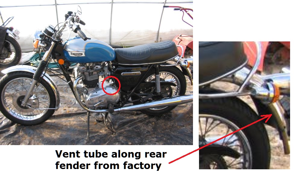

On my BSA Cyclone engine the crankcase vented through a tube that directed the oil mist directly onto the drive chain near the engine sprocket. Ed

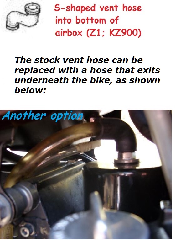

K&N says the crankcase vent filters are designed for the high demands of racing. [Snicker-snicker-wink-wink]. Without further ado 'bout those high demands. And neglect to mention any professionals using them. But do take the time to also plug sale of K&N's filter cleaner and special red oil essential toward maintaining the filters.
Other options for an open nonrestrictive breather hose would be routing it to exit underneath or behind the bike.

24 Aug 2016 00:31Patton wrote: K&N says the crankcase vent filters are designed for the high demands of racing. [Snicker-snicker-wink-wink]. Without further ado 'bout those high demands. And neglect to mention any professionals using them. But do take the time to also plug sale of K&N's filter cleaner and special red oil essential toward maintaining the filters.
